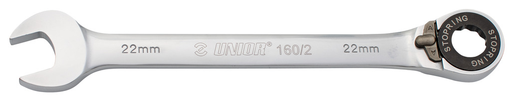

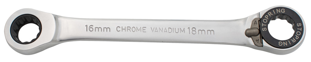

Also been looking at ratchet wrenches lately and see Unior have an interesting design with a 'stop ring.' I assume they are also Taiwan.
Also reversible box on both ends.
https://uniortools.com/eng/category/940654/ratchet-wrenches

Saw these few days ago. They look - nice. As it happened with most of Unior stuff, I recommend not buying. Dropped quality horribly.
Good design feature though. I ran into this scenario today, had to tighten some bolts and ratcheting wrench kept slipping through. :mad:

Facom 467b you get the removable stop ring clip, one of slimmest box walls available, practical ergonomic design and finish plus they not always that costly if shop around and available standard and metric ...
M6erfan
Dec 6, 2014
10,170
'Merica!
They have a stop ring built in?
Mr_B
Nov 21, 2016
5,385
Reading
^ Yes, bypass/removable stop ring .
