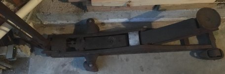

I asked about a vintage jack a while ago and one of my friends picked it up and delivered it for me today.
Weaver. 51.5" long, 5.5" saddle. Likely a 2 ton.
Unfortunately description by seller was wrong - bought it unseen. Was told that all wheels work, jack needs some oil and is stuck...
Well - it's rust frozen except for handle. With a little bit of rubber mallet I started moving the pedal and released the lock handle (which probably needs to lock on a half-circular piece at the bottom which probably moves up...
Discovered that the cover from label till rear wheel is missing. Emailed the PO today - may be I get lucky? (doubt it though...) The last picture here shows some corrosion on the rod going into hydraulic unit. I hope it can be cleaned up without machining (it probably goes against rubber seals which might cause problems if not tight).
It was left in the dirt somewhere - some rust on the bottom, one of the springs is broken and there is another very corroded, there is another part on the bottom which will need replacement, the bolt on the left part of image 9 is moving freely...
Well: tons of negatives...
Positive: I could not find another picture of this jack on the internet.
I am out 40$ as of now
How bad did I do?
E-mailed Castle Equipment Co for jack diagram...
I never restored a jack in my life and never tried to fix anything that complex which is rusted solid.
Any advise would be appreciated (including what would you spray it with when attempting disassembly - I think WD40 would not work and evaporust would be too expensive for the size)! PB Blast?
The work is busy, but I will start slowly working on it as time permits using all the advises.
...I wonder how much it would cost to professionally rebuild this hydralulic unit?
Does anybody by any chance have a similar complete or parts jack? If it's a parts one, do you have a cover? If complete, can you make pictures of it? In case I succeed with the restoration and make it work, I assume that somebody can create a new part for me - it's a bent plate with the designers detail at the bottom - I hope it would not cost me an arm and a leg to have a machine shop make a reproduction...
All ideas will be greatly appreciated. I am well over my head with this one...

I’d give $40 because I’m a weaver nut and the older models are getting harder to find. It’s going to be a project and possibly a total loss in regards to the hydraulic unit, It very well might need a New cylinder, Pump piston along with a New Main Ram. I’d pay close attention to the Valve seats and release seats also... A seal kit should be the last thing you buy. I knew when looking at your original thread that it had been outside for many moons, that patina isn’t shop corner normal... Not to mention the old dried up leaves tucked away in the frame rails.
Good luck

Thank you, Hiball. I will keep it in the corner of the garage for some time to decide what to do. I emailed the company and am waiting for more information on a model and if they still have parts.
Ndnchf - the skirts and the style were part of the reason I liked the style so much.
Garth, I would like to have a working jack like that, but I made a decision based on wrong information presented by the seller (unfortunately unseen - was told that the wheels work and it just needed some oil. They refused to send any pictures and did not provide the dimensions just saying it would fit in any car...). Well, trusting people does not always work. I thought it would be just surface rust and possibly seal replacement). As Hiball mentioned, it may need a whole hydraulic unit
I will try to collect more opinions from GJ and information for now to see what is going to be the plan for it, but not giving up on it yet...
Over the past few years, I've purchased four "vintage" jacks. None of them was ready for prime time. The one that came from Craigslist, seller told me all the casters were good - except for the one he didn't tell me about. The others came from various auctions - one is a parts jack for it's mate that became my #1, another had so many issues, I gave it away. Another one had enough repair and machining, that I now refer to it as the "$800 floor jack" - and I still don't like the release on it. In general, they live hard lives - by the time they go to a new home, many are ready for a rebuild or plagued with bodges from a previous owner. "Needs some oil" has become the catch all phrase for "something's wrong with it, but I don't know what".
At any rate, $40 is not much of an investment. It's a beautiful old jack, and I look forward to seeing you dig into it.

Well, as the old Russian proverb says "The eyes are afraid, but hands are doing the job"
I will slowly start the project and will try to document on the way I go. I could not find another jack which is identical on the internet - may be this write up will help somebody to restore the one they have somewhere in the corner on the garage. I will also ask questions on the way I go. Sorry, it will be a slow project...
Had some time today to start disassembling the jack. This is probably the easiest part of the whole project - took off the rear left wheel assembly. The nut size is 3/4". Some WD40 and a little bit of pushing and I was able to remove the assembly. Above and below are old style bearings with 16 balls each (you can take a guess how I know as they promptly rolled all over the floor from the bottom...). The grease was hard as a rock on the bottom and a very high density clay consistency on the top.
The rest of the stuff is solidly stuck at the point.
- the axel (not sure of the proper term) is rusted and damaged on one side.
-I assume there are some bearings inside - may be cylinders inside the wheel around the axel...
-What type of grease would you use when reassembling it?
-Would you use slow soak in WD40 initially (and then evaporust if it fails) or any other solution? Need to try to preserve ornament on the side - thus will try to avoid combination of ATF and acetone which people recommend for now...
Information about ball bearings: 16 balls on top and 16 on the bottom.

Cool old jack. Heat might break stuff free without using chemicals. Bicycle repair shops are a good source of single ball bearings if you need any. I don't think the type of grease is critical. Good luck.
paulsomlo
Jul 16, 2013
3,979
Northern Colorado
If you're talking about removing all the surface rust, I'd say electrolysis, maybe evaporust for the small parts. I've heard talk about using a mix of molasses and water, not sure if it would be thick enough to brush on the frame and have it stay there.
First order of business though, is to get the hydraulic unit out and apart for inspection.

I am trying to unfreeze the wheel first so I could at least move it. It's sitting in the garage now and unfortunately I do not have a place to put a large work bench (wife would not be able to help with moving - it feels too heavy - at least 100-120lb). My idea was once it is movable, I will try to take it outside, lay it on the side and try to take it apart.
If time permits today, will try to wirebrush the sides and put some WD40. and see if it soaks in.
Electrolysis is a good idea, may be will try it - will require a huge plastic been to put the whole jack in. Never did it before.
Still waiting for Castle Equipment to send me the diagrams - will have to give them a call this week. I am also interested in learning from them how much would be a hydraulic unit if it's a complete loss - I have no idea what is my worst case scenario cost wise...
I wonder if heating the wheels up in the oven and then throwing them in cold water would break the rust and free them or would cause more damage through bending the small parts which are used as bearings (probably small cylinders around the axel)

Maybe get a dolly under it, so you can move it around. Divide and conquer - at 5'7" and 140 lbs, my strategy is usually break them down into pieces that I can lift, ASAP. That usually means working on the garage floor or the driveway.
New hydraulic unit for that? I don't think you want to know.

How bad? $400? More? I hope that it can be rebuilt...
One of my fears is that there will be no available parts. Custom fabrication could be expensive.
Picture 7 in the first shows the rust on the rod going from the lifting part with saddle to the hydraulic cylinder (sorry, I do not know the proper terms...). My hope is that once I can clean that up a little bit and free the rust on the frame it could move. This would point me towards higher hopes of rebuild vs replace (if financially not too crazy)
I think that the hydraulic unit is completely try: tried to move a pedal with the mallet, it moves (picture 8 (the first one on second post), but appears very dry and covered with dried grease...
Breaking down would also be complicated by significant amount of rust anywhere - I suspect it will not be a short breakdown. Having a family I am basically working on projects between work and family responsibilities - usually 15-20 minutes at a time...

Ditch the WD40 and get a good penetrating oil. WD40 is almost useless for this purpose, despite what it says on the can. I suggest either Kroil, PB Blaster or a home brew 50/50 mix of automatic transmission fluid/acetone. Keep the later in a sealed oil can or the acetone will evaporate. Soak your parts for a couple days with this. It wont necessarily work miracles, but it will help. Heat will be your friend too.

I tried to look more into jack last night. It has a lot of cotter pin connections. I think if I could succeed taking out around 5 cotter pins and separate the connections, I could take the hydraulic unit out and try to clean it up and take it apart to see how bad it is. The problem is that holes through which cotter pins go appear to be solidly rusted. Will probably have to go slow with some sharp tool and PB Blaster sprays.
I tried to call Castle Equipment today and spoke to a nice gentlemen who told me that they did not have kits for something that old (and unfortunately no diagrams for this jack). However, he gave me a phone of another gentleman at Weaver plant who might know the history of the jacks better and might point me in the correct direction and potentially give me more information. The search continues...

1. After some PB blaster sprays, light hummer hits and some pressure applied in both directions the bolt on the handle was freed. This allows the top button to go up and down (well, mostly down - probably there is some spring inside which rusted or is weak). Have to pull it back up with pliers. Tons of rust fell from inside...
2. Two cotter pins from the top of the jack finally started moving and can be taken out.
3. No luck with the screws on top of the plate covering hydraulic unit - will keep spraying with BP Blaster. Same with the screw to fill up the jack hydraulic unit.
4. One of the cotter pins on the removed wheels came off. The other one is solidly stuck and somewhat broken. Keep spraying BP blaster on top - hopefully the whole axel will eventually come off and I will be able to free the wheel.
5. The cotter pin connecting the handle side of hydraulic unit started moving after some work - might come out. This side will probably be not that bad to remove.
6. The cotter pin on the other side connecting hydraulic unit to the part which is lifting the car is rusted and in somewhat awkward position with the "tails" of cotter pin facing away from the bottom. They are probably easy to reach once the top cover gets removed, but will see.
7. Couple of cotter pins on the front of the unit under the cup started moving and will probably be removed soon with more work.
Sorry - a lot of tiny progress points, nothing major. This will take time and be initially boring to read about. Eventually I hope to approach the most interesting and scary part once I find a way to remove hydraulic unit (I will do it without disassembling the whole jack as parts are welded...)
Interesting observation - when I wirebrushed the very rusty wheel unit which I removed, there are remnants of red pain on it (consistent with the color of Don_Long, though I have more rust then paint at this point). On the bottom of hydraulic unit there appear to be some green pain remnants. I thought Weavers were black or green for early models.

Don, I think we have slightly different versions of the jack:
1. There is slightly different distance between parts (please see the pictures)
2. Your cover is rounded towards the handle side, mine is flat
Do you have the same jack size as mine?
Please make me a picture of the rear of the jack from the left side (from the pictures above I am possibly missing a part or have a different mechanism. I do not have this bolt. The picture is taken with handle up.

Thank you, Don. My jack is different. I checked my jack - there is no hole for the safety stop on the panel.
I guess we both have similar but unique jacks. I assume the majority of design is similar - will keep posting pictures as I keep taking it apart...

Had a small progress today after work. I put sizes on the bolts in case somebody decides to work on similar or the same jack in the future.
1. All bolts marked 3/4 are finally loose
2. I removed the part with 5/8 nuts (it either broke or rusted off) - once the cover is lifted, will need to see if the second half is there and figure out what it is for
3. loosened 11/16 nuts which are now moving freely
4. the yellow nut to the right of 11/16 nuts is now freely moving
5. no luck with 7/8
Made no progress with the right rear wheel assembly - needs to be soaked further. I assume the axle can be moved with the hammer once cotter pin is removed, but have no luck. The wheel is still frozen...
The screws which I mentioned in previous bolt are still not moving (second post, second image)- keep soaking. I wonder if I will end up learning how to use the manual impact driver. The metal is bending out of shape. The side bolts can be probably grinded off if needed, but the filling screw is a problem... Will keep soaking for now

For fasteners with slotted heads, manual impact will work wonders. Either that, or square shanked screwdriver with adjustable wrench on the shank.
S
Shelbylex
Jan 20, 2018
3,169
I tried a large screwdriver with the wrench on the ?nut (not sure what to call the nut shaped extension under the handle on Snap On screwdrivers) - it just keeps spreading hole on the top of the bolt. Tried another less valuable screwdriver with good counterclockwise hand tension and slight hammer hits on top - no luck.
Will continue soaking it for some time. Might need to borrow/buy impact piece with slotted screwdriver end. Have the impact driver, but only philips and sockets on it...
I guess there is a long list of tools I need.
One thing I noticed - trying to use mostly 6 point sockets. I think 12 points might work just as well, but for some reason feel more afraid using them and damaging the bolt heads... hmm, I think I will start paying more attention to 6 point wrenches and sockets from now on...

Small progress:
-Was able to completely free and take out cotter pins on top of the jack
-Removed cotter pin on the part connecting hydraulic unit to the pedal and remove that part. The part which I freed with additional picture in the 3d image shows how significant is the rust damage on some parts. "Just needs some oil they said" : ) I assume that the part which crosses two plates and goes left (image 1 shows it better) can be removed with time and replaced instead of being one piece...
-Tried to remove the 1/4" square bolt from the pedal, but no luck. Slight movement after soaking, will need to work on it more
-Finally after a lot of soaking and light hammering was able to take apart the rear wheel assembly. The damaged/rusted/broken part of the axe still has the cotter pin - it broke and I could not remove the reminder. What really helped is slightly moving the axel with the hammer, soaking with PB blaster, tapping it back, soaking more so it would get inside the assembly, tapping it back... "repeat once more..." Eventually it came out with me using a small aluminum cylinder of similar diameter to push the axle through... An interesting thing is that I expected bearings inside the wheel (a lot of small cylinders), but it appears to be solid inside.
I guess this project gives me a reason to use my older tools which I am slowly collecting

So you don't think you can save that part in pics 2&3? Lol. That's got some pretty rough parts. All can be remade with enough time, effort, money, or some combination of those. Sometimes progress on old tools goes slow.
S
Shelbylex
Jan 20, 2018
3,169
It will buff right out! After all, the seller said it “just needs some oil”
Once I take it apart, I will need to see if some parts will be similar to modern version of the jack. I assume some parts will need to be remanufactured. The biggest gamble is the hydraulic unit...
