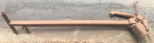

Small progress after a lot of work.
I finally took off the side bolts and separated the handle from the jack

...Continued
The big bolt is 1 11/16 I guess I will need to borrow a large wrench from somebody. Do not want to damage the bolt with large pipe wrench
I also succeeded in taking off the second rear wheel assembly. It appears that at some time in the past it was taken apart. The top of the thread on the mechanism is damaged (though it is still good enough to hold the top nut). I am also missing 2 bearing balls (there should be 16 on top and 16 on the bottom. There were 15 and 15. The size of the balls are approximately 0.249 inches (measured four random ones at 0.248, 0.249, 0.2495 and 0.25)
Does anybody know where I can get a replacement? I just need two of them.
I looked online and found the Everbilt steel plain ball bearing in Home Depot for 85c/piece, but I am not sure if this will be a good replacement (I have no idea what original ones were made of; the Home Depot States that they are made of 25 chrome steel)

I’ve never seen anyone take a weaver frame apart... Obviously this case is different. Normal procedure is to Remove the Pin from the pump piston linkage, pin that controls the release, Pull the Two cotter pins on top, pull the 1 cotter pin that secures the end of the Ram to the lift assembly and once it’s freed you simply remove the unit from the topside.
The Big Nut on the Bottom is reservoir Oil filter, only thing in there is a screen and Magnet, big nut on top is valve plug. I would get the hydraulic unit out of the frame before attacking them.
The beauty of the weaver design, welded frame, Hydraulic unit Service without the need to dismantle.... So much for that... Ha!!

Agree, PaulSuomo. My concern is the rod which goes from the hydraulic unit to the lifting arm (the one at the bottom below the unit in the image in post 42). It is rusty. I hope that rust is not too deep and can be cleaned up without the need of replacement.
Thank you for more information, Hiball. I think that taking out the unit would be a little more complicated than it looks. You are right - the frame is welded. The hydralulic unit has two U-shaped sides which are held by large "pins" located to the right and left of the bolt which is slightly above the wheel assembly (post 42, image 1). The unit needs to go down to be released from that. The cotter pin wheich secures the end of the ram to lift assembly is solidly stuck at this point. The "tails" were inside the assembly. I took off the part which is facing is in the picture and tried to push it through with the punch, but no luck. Started soaking...
The problem which I will be facing is once I push it through, I will need to turn the lift ("in the direction of lifting it) to try to release it. At this point the whole assembly is solidly stuck with rust.
P.S. Unless you already figured it out, I do not even know the proper names of the parts of hydraulic unit. This please disregard if I do not call things properly.
I measured the Valve plug at 1 11/16. I will measure the Oil Filter nut when I take things out.

Once you release the lift arm shaft from the Main Ram, you can orient the hydraulic unit to clear those dogs on the inside of the frame rails and pull it out. It’s common that it’s froze in that Bore, even on well cared units. I always clean them up with a small die grinder and heavy dose of bearing grease upon reinstallation.

Picture for clarification, Remove that cotter key and that rod (with some help) needs to come out, and then you can remove the hydraulic unit. I have some large chisels that I use to persuade it, work from side to side till it decides to cooperate.

Using a pair of side cutters and leveraging against that swivel joint should make quick work of that cotter key, if the rust has taken hold just clip both sides flush and punch the remnants out once you get in a vise.
That Rod is rough... that’s going to be a complete loss I’m sure.

The tails are on the other side and the piece broke off completely. I will soak it for couple of days and push it through with a punch.
About the complete loss: you think just the rod will need a replacement or the whole hydraulic unit?
If this is just the rod, I hope that the design of the hydraulic unit did not change too much. I looked up the available parts from the Weaver - S6633 rod is available at 92.64 (with the ram assembly AS-6633 available at 215.46)

I hate to speculate, but that rod when the jack is n the down position is protected inside that cylinder, to see it at full extension and in that shape doesn’t inspire a lot of confidence. Honestly you won’t know till you put eyes on the inside.
The core design of the weaver hydraulic jacks hasn’t changed much, with exception of the 2 ton models. When you get to that point you will just need to take some measurements and go from there, if memory serves the differences are mainly on the pump piston bore/rod size.
