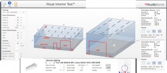

Hi Everyone,
So after some delay because of other things coming up in life, I am back to getting ready for lights in the garage.
Background info: 48x30 garage with right side bay(16' wide) having 12' walls and a 4/12 pitched interior ceiling. The rest of the space has 10' wall with flat ceiling. See attached pics of the garage. Note: the whole space will be drywalled and painted white.
I did use the tool using the Lithonia 4ft. LED tube light fixture. I think it is close enough to the ones I am looking at - mainly because I want dimming capability.
For the flat ceiling area (32x30) I ended up with 18 lights to give me 84fc at 2.5 plane. This is spacing of 6x3 (as in the visual tool pic). If I add 2 more lights the pattern goes 5x4 to give up to 94fc but the pattern, to me, is much busier.
For the lift bay, I kind of guessed on a ceiling height of 13 to balance the scissor truss. 12 lights gets me 90fc.
I think this is the light I will go with https://www.ledlightingwholesaleinc.com/E5SLB35D4-850-p/e5slb35d4-850.htm?CartID=1 at $45 each.
Am I missing anything? Thoughts on my layout before I pull the trigger on the order of 30 lights!
Thanks,
Joe

So nobody has any thoughts or comments? No way I am that good. :)
Of course I have been poking around and thought about the Maxlite dimmable fixtures here: https://www.prolighting.com/commercial-lighting/led-shop-lights-and-commercial-lighting/dedicated/ls-4846u-50.html
The LS-4846U-50 is a 46 watt, 48" linear LED strip fixture that provides 5,986 lumens of 5000K daylight white light
Compared to the original light I had thought about:
LED Lighting Wholesale Inc., E5SLB35D4-850, that has 5,181 lumens using 35 watts.
For the same FC for my 32x30 section I would need 21 of the E5SLB35D4-850 lights and only 18 of the LS-4846U-50. So I am looking at the difference between a 6x3 vs 7x3 layout and the total cost of the 18 is about $205 more compared to the 21.

Maxlite is a known brand in the lighting industry that's been around for over 25 years. No one's ever heard of the other brand. Plus, the warranty is twice as long with Maxlite.

So what are the thoughts on my layout orientation - since my workbench is against the back wall should I rotate my lights 90 degrees so the 4 feet length is left/right instead of front/back?
I think I will be ok since the spacing is 5 feet from the wall to the center of the lamp - which means the end of the lamp is only 3 feet from the wall (and my room dimensions are exterior so I am really losing 8-12 inches anyway...)

I think it's fine. Rotating wont change anything. Overhead lighting is for general illumination and task lighting is used to fill in where necessary. You're doing great.
