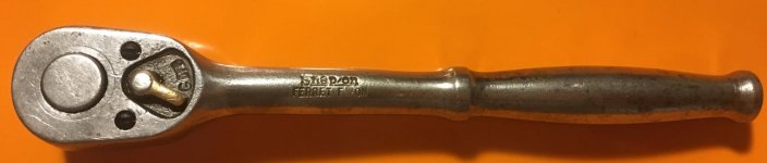

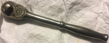

I to restore/save old Ferret 70N
It was not holding position well and the direction level would not move easily. I took it apart and noted that the original grease became almost rock consistency.
I actually used a small knife and a screwdriver to start cleaning the gear wheel and the area. I did not remove the pawl as it needs to be punched out and I am afraid I might damage something. Tried to clean around with the pick. A lot of gunk came out, but some is still left.
What would you soak the parts in to clean it?
I have some WD40, PB Blaster, Evaporust... Was hoping to see if it will move better and possibly work well once all the caked grease will be cleaned out.

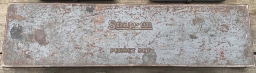

ATF sounds like a good idea to me, too. When you get that working, it will be a nice 1945 wartime example. Here is mine marked 1944 along with the rest of the Ferret set.

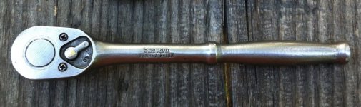

I would like to thank everybody once again!
I took it out from the ATF today, cleaned, put some superlube in and put together.
I decided to go with the two black non-original screws (one was missing on it and I decided to have both in the same color and used new ones)
It's unbelievably smooth now!!!
