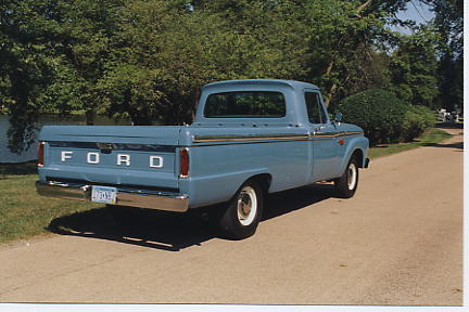

There will probably be some holes in the radiator support, too - leaves and dirt get caught down in there where you can't see it until you pull the front clip apart.
My '66 is the same color, Marlin Blue. :cool:

I have some other photos if you need any details for reference, although they were on film so I'll have to scan them.
How's the seat upholstery? In one photo you can see a corner of the original seat upholstery and it looks to be in good condition, but since there's one of those saddle blanket covers over the top I assume there are worn or torn areas. You can get repro rubber floor mats, but they only come in black - the original in that truck would have been blue. They also have carpet sets available.
When I did my truck I bought a lot of stuff from Auto Krafters and from Dennis Carpenter, they both have pretty good catalogs. There are also (or least there used to be) a couple places in the Kansas City area that have a lot of used parts for these trucks. I haven't spent much time there, but there is also a forum for 1961-1966 Ford trucks: http://fordtruk.com/forums/
