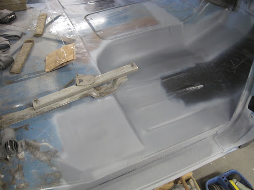

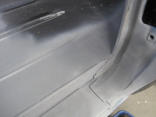

Just realized I didn't show some of the "after" pics of the work started on the previous page. Below is the interior with the floors and door jambs replaced, as well as the rear cab corners.
this one has to be looked at with another from the same vantage point (most everything here is missing in previous photo's)

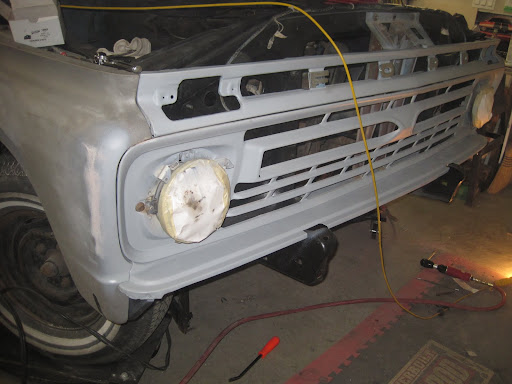

Some Front End photo's - got lucky (!) in that everything lines up after the repairs:

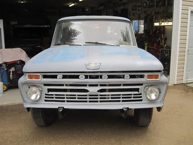

OK boys, this is my last entry for this as I'm DONE! Owner picked up the truck yesterday and loved it. He's gonna put in a bed liner, do mechanical and interior work, then have it painted. Thanks all for looking and the kind comments!
I like this pic as it shows such a change from the before shot!!
Most everything you see here was replaced...
All fits too!

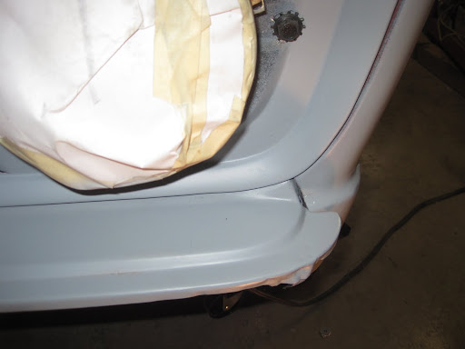

Tailgate has new metal in both bottom corners - as do the lower box corners...
