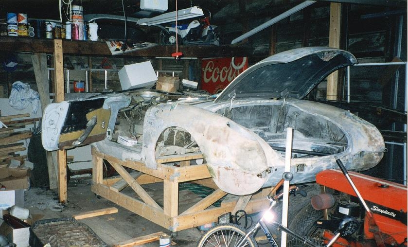

Not to hijack your thread, but here's a 55 Bird I'm helping with now. This is the biggest piece of rolling oxidation I have ever worked on. This thing had been settling down into a dirt floored shed since 1968. :shocking:

the floors I got for this left a lot to be desired, even tho I thought they looked OK to start. I had to bend a lip along the top and they wouldn't sit flush along the entire mount - but that may have also been the mount shape. At least they where 16G!
CC - that t-bird is ROTTEN - but something that'd be a joy to return to it's former glory. Something that most everyone can see putting the time into. Did you start a thread for it somewhere? Good luck with it!77

CC - that t-bird is ROTTEN - Did you start a thread for it somewhere? Good luck with it!77
No, I need to. It will be a lengthy project. :thumbup: We finished a 58 Vette recently and were able to keep a pretty good weblog on the C1registry (for first generation Vettes). I haven't been able to find anything like that for the early Birds.

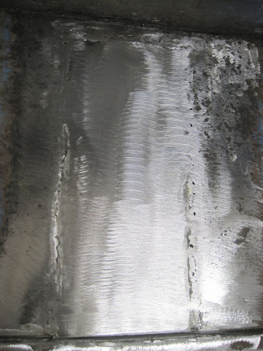

Had a day before my next trip (Jamaica conference) so I got the drivers floor fitted and welded in.
Trimmed the pan again - little by little...
Here's my metal-working station. Not quite as stout as Jack Olsens :bowdown: - but it's a good slab of hardened steel (that's what she said!). Plus I have a bunch a pieces I use for shaping and bending. This is a lip to attach the floor to the kick panel;
A little shaking on the welding - it's easy to get out of practice! Little extra grinding will make it all purdy!
Interior nearly done. When I return I'll start the cab corners....

Now for this mess. It was a toss up between cutting it all out and trying to make a new piece, or making smaller bits and fill-welding it. I always like to save original parts where I can,becuase (a) they're original, (b) they fit, and (c) it can be faster - sometimes....
I held little pieces up in behind to back-up my welds to fill the holes.
Grind out the thin stuff first...
Grind-fill-grind-fill-grind until done...
Now the outer piece get welded on. I have started using plug welds where I can becuase it helps keep the panel flatbefore welding the seam.
Some grinding and a skiff of fill and she's done (the "metal work" part anyways!)
