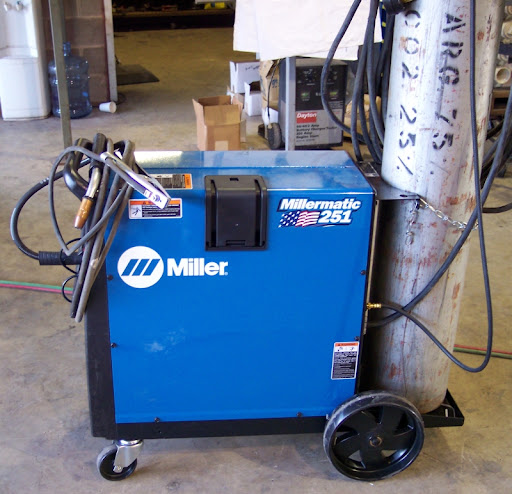

Zrexxer - that is a really nice looking flux core weld there....what machine??
Thanks, that was done with a Millermatic Vintage.
However, thinking about the OP, there's an inexpensive 120V fluxcore machine on the market in the last couple of years that I've really been impressed with - the Hobart 125 "EZ".
I bought one to play around with when Tractor Supply had them for $250, and I have to say, I was blown away by what that machine can do. I didn't expect much on 120V service, but that machine exceeded all my expectations - to the point that I will grab it for many small jobs before I'll set up any of by bigger machines.
If someone is looking for a small fluxcore only 120V welder, I can't recommend the 125EZ highly enough. Hobart really got this one right. These welds below were done with the little guy:
