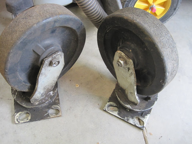

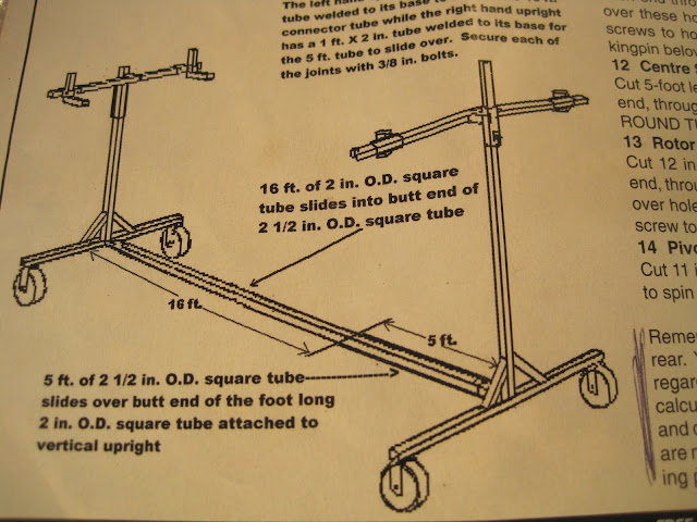

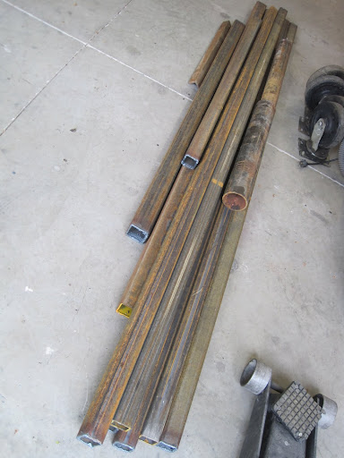

Finally getting to the rotisserie I've dreamt about!! Bought the steel last week, along with casters. The casters had just come in to the Steel Recycler and where on the scrap pile. I grabbed a wrench from one of the guys and went out there in my shorts and flip flops to unbolt them - while the guy swinging the GIANT magnet was working right behind me! :wtf: Being aluminum - and because everything is sold by weight - they came to about $4 each!!!! These are 5inch, ball bearing in cup, aluminum wheels. Perfect for this project!

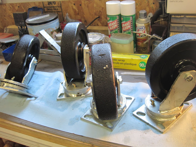

Wheels cleaned and greased:

There are also some free plans on Autobody101 as well. I looked them over yesterday and they didn't look too bad. The file you download has the full drawing inside of it.

I bought all the steel and casters for $220 at my local steel recycler. All the Grade 8 nuts and bolts where another $30. A spool of mig wire and a bottle of Mig-mix will be another $60. So I'll be about $310 without paint (I'll just brush it with POR 15 that I already have). My time of course, is free and I like making things, that's why I do what I do - but if you didn't - then buying a nice one for around $1000 would be a consideration for sure. An interesting side note is that the instructions called for 4-5 cut-off wheels for the saw.....I used about 1/2inch of one 14inch wheel to make ALL the cuts (pics to follow!).

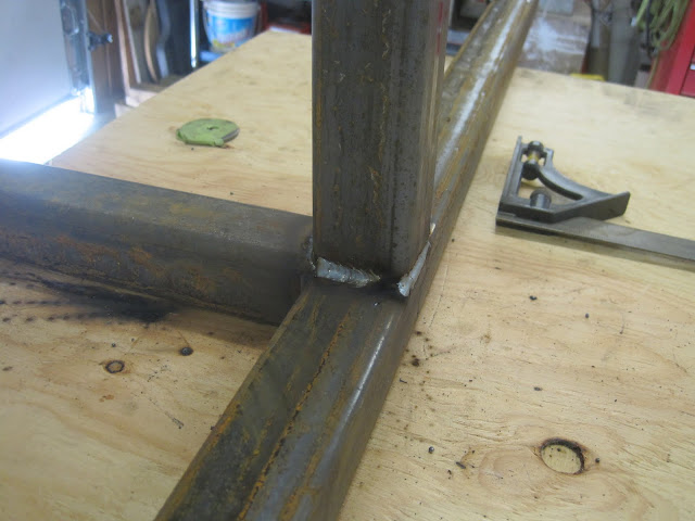

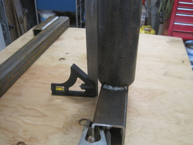

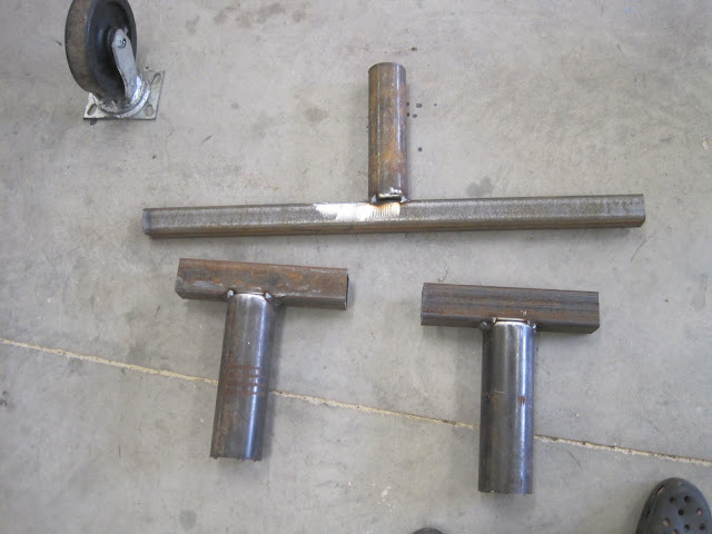

After getting most my other projects done - and another rainy day in store - I was able to get the welding done on the rotiserrie!
These are the rotating bits:
All that's left to do now are to drill holes for the bolts, pins and casters, then fabricating the attachment points....

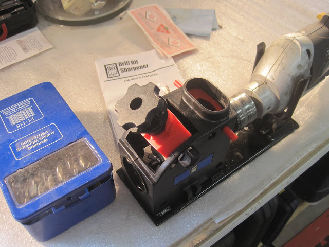

Further progress today on the rotiserrie by E-tek and Sons:

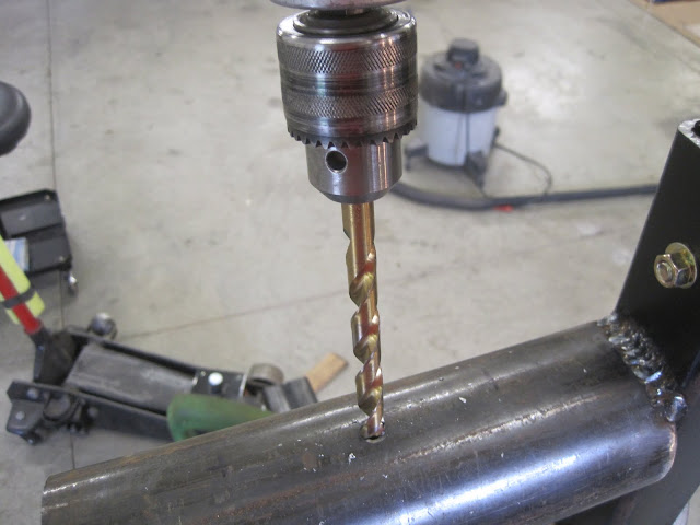

One thing I've realized is how CRAPPY are the drill bits I've been purchasing. Sure, they've been OK for sheet metal for years, but I ruined 10 or more drilling holes for the casters! I'll need to spring for some high quality bits to drill all the 9/16 & 7/16 holes required for the thumb screws and pivot pins!! What do you guys suggest??

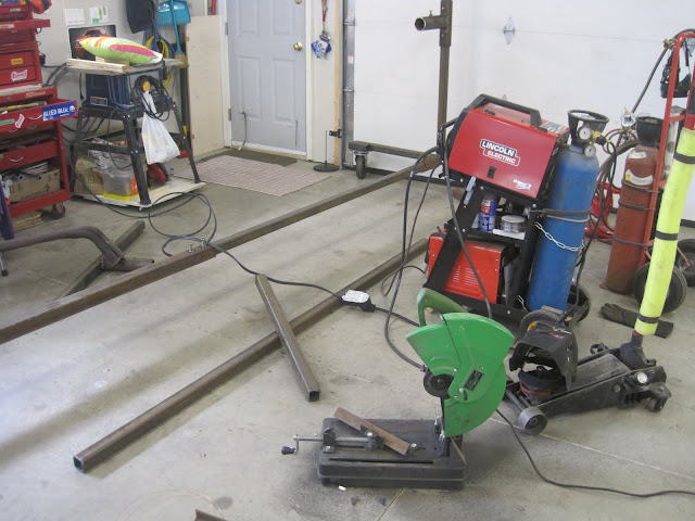

e-tek - what are you using to cut your tube steel? I just burnt up a Lennox 10" metal cutting blade 21886 in a miter box. Blade is rated to 5200 rpm, saw spins at 4900, so within specs. Blade is rated at 3/16 wall, I was cutting 3/16 wall 2.5"x2.5" tubing. I got 4.5 cuts and that was it. First 3 cuts were nice, went downhill from there.

Sorry - didn't see this...I'll check the brand later. It's an ABRASIVE cutting wheel, not a metal one. The same wheel has made about 20-25 cuts and was about 40% used doing this.

I have since bought an abrasive disc, works fine if you don't mind the dust, sparks, heat, and required grinding of the flash. Discs are quite cheap though.

Yup! The one I am using is a cheapie Powerfist - but they cut!!

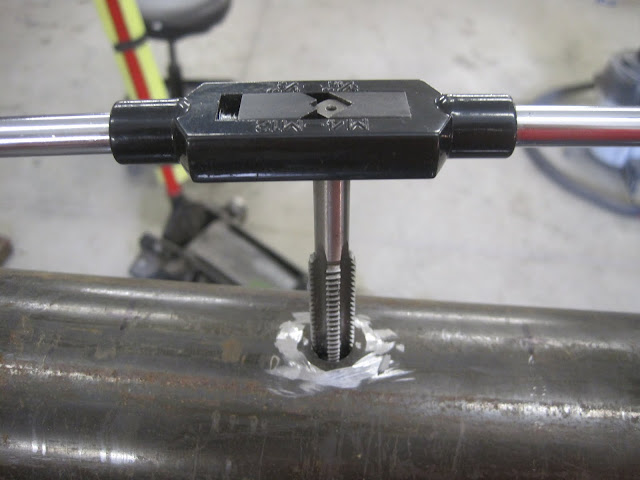

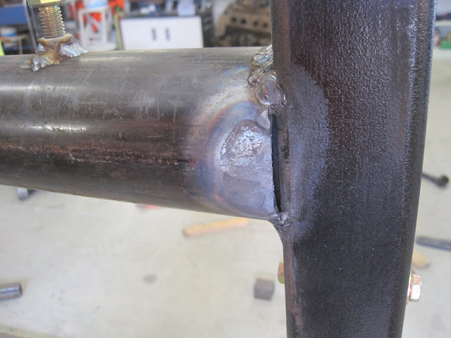

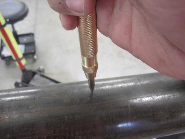

Not a BBQ!!:bounce:

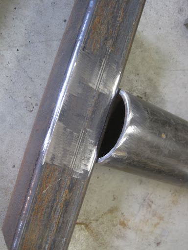

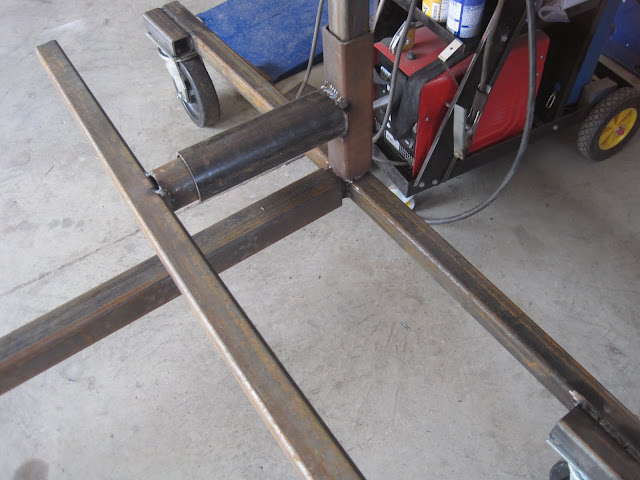

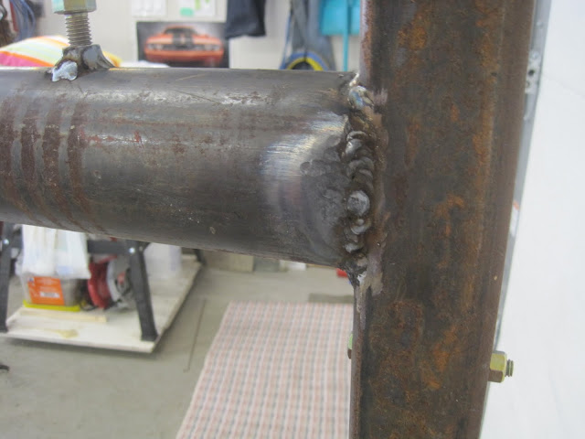

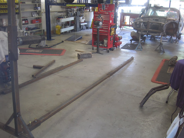

Got a bunch done on the rotisserie today (at least I THNK I did ;))
Here's what's going on it...

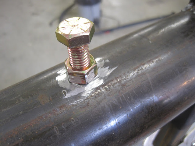

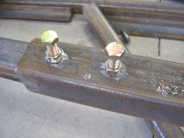

Thumb screws for rotating part and bottom connector:

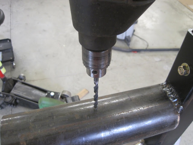

Switched to a titanium bit for the 7/16" holes....but still had to sharpen it after every 2-3 holes...
Using my NEW sharpener (works good!)

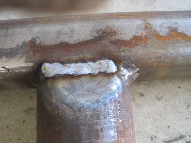

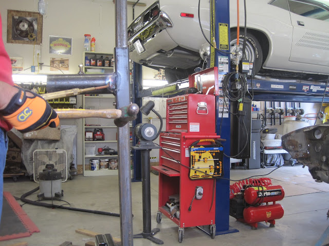

Two things going on in the next pic: The bolt is weled to the tube, finsihing the "thimb screw" and something I needed to address was the gap from the larger tube being welded to the upright. At first I thought about adding a piece in there, but then I thought if I just molded it closer I could weld it up and keep the one-piece strength:
Everyones favourite tools: BFH and the fire-wrench!!
Then I welded it up - no really, that's welding!!:bounce:
Last up was some gussets for the uprights.

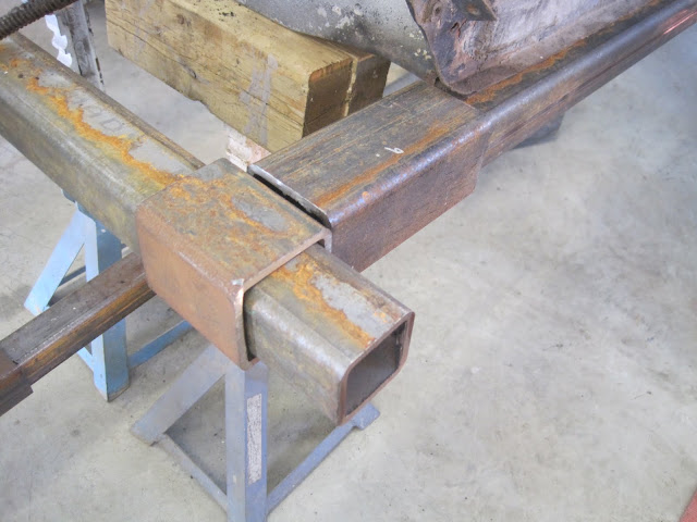

Then I removed the one end, placed it at the back of the car and slid the centre section under the car. Tomorrow I'll attach the arms to the car and jack it up to attach it all together (hopefully..). The difficult part will be attaching the front arm - not much there to work with! Thanks for looking!:beer:

One thing you might want to think about is putting the tie bar between the two end uprights lower to the ground. You don't want to raise the car any higher than necessary to get it to flip over. This is what I did on mine and it works fine. It also strengthens the caster mounts

MOPAR Mania car show here today, so only got a little done on the twirler.... that's my ride up front (alomg with some old and young Mope fans!)
My fave ride there today:

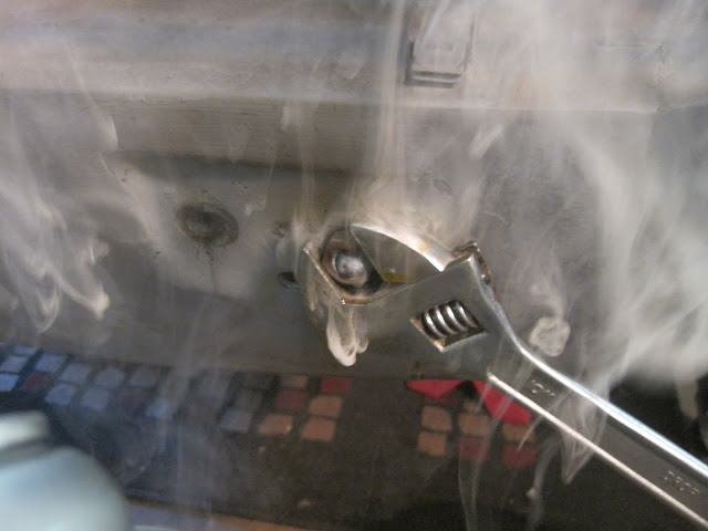

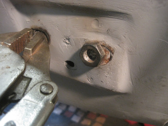

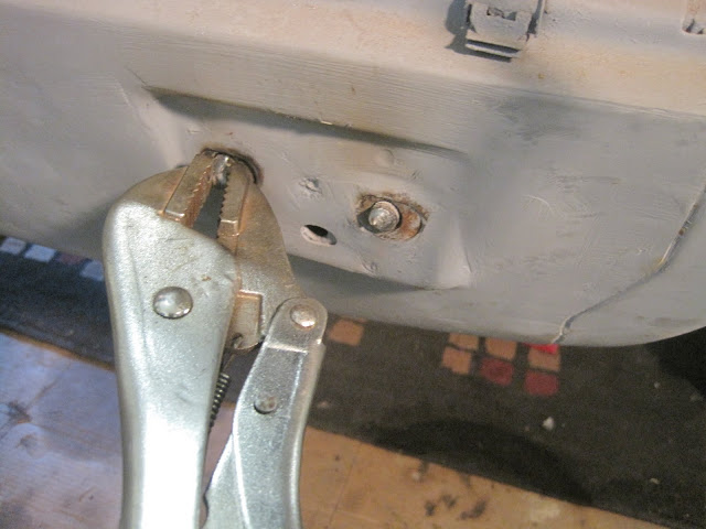

When I got back I realized I had to remove some rusted and broken-off bumper bolts before getting measurements for the rear bar.
Welded a stud onto one bolt - and a nub to grab on the other - both worked...
with KROIL and HEAT!!!

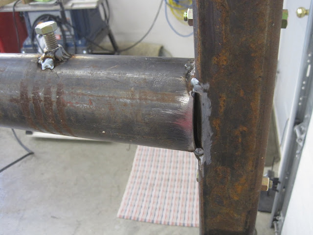

Also heated, bashed and welded up the front end tube to car-bar portion. Tomorrow I just have to spend some time making brackets and bolting/welding them to the car. I think my welding improved overnight! :headscrat:bounce:
D.J.
Sep 16, 2009
1,116
New Haven IL
Tek: Nice job and I hate to mention it but if you made the pipe open on both ends at the lower horizontal you could slide the lower horizontal pole thru the bottom of the upright and it would make it easier to store and you wouldn't have to have different length poles for various projects of differing lengths. Unless you are doing this on the other end of the build? Just my $.02
Thanks guys - love the input. The uprights each have an 8inch piece welded to the front, that the two long peices slide over, then onto each other. So the two uprights won't take up too much room really...

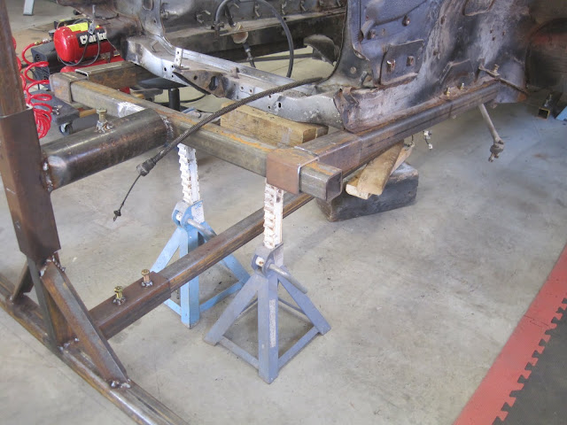

Saskatoon, SK

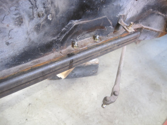

Lining up the front end attachments....
I ran sections of square tube down the frame rails to minimize the chance the rails would twist under the load.
I drilled holes for grade 8 bolts to attach the arms to the frame tubing, then I'll weld the over-sliders to the portion that slides on the arms.
