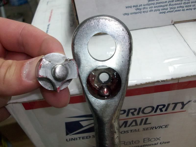

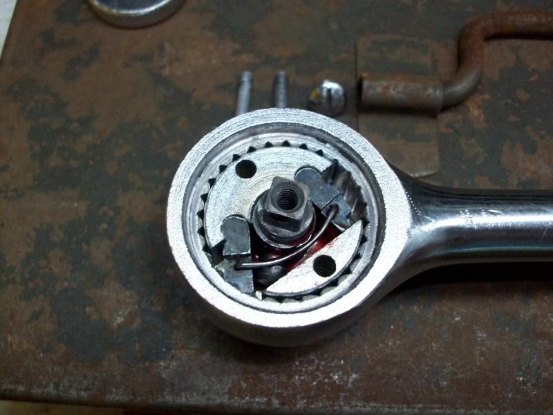

Hi Guys
Bonneyman just asked me to post these. Its a Ward Master I got this last fall.
Its a pretty trippy mechanism. Oh and its just grease, George ;)
yours Scott
