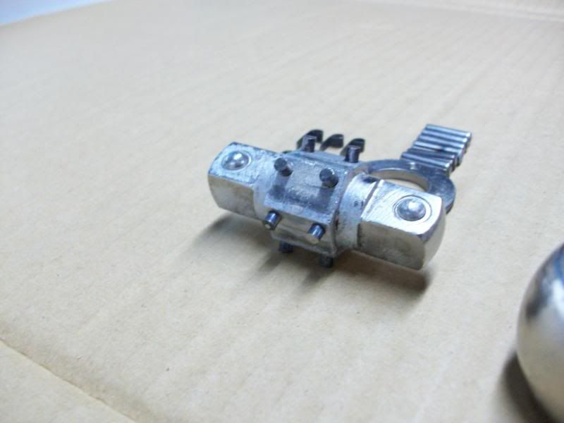

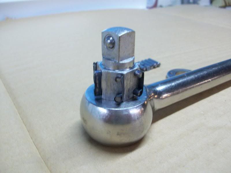

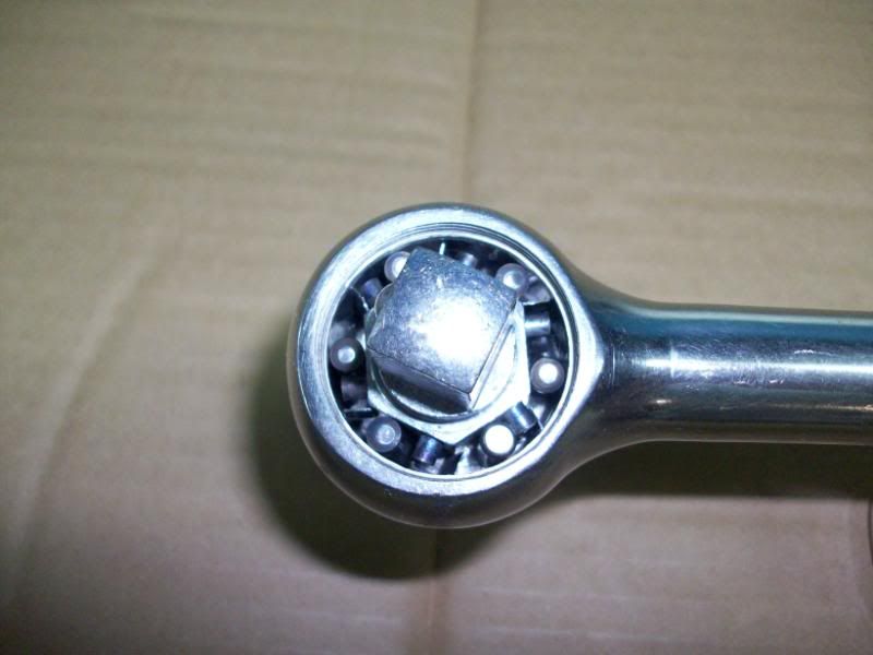

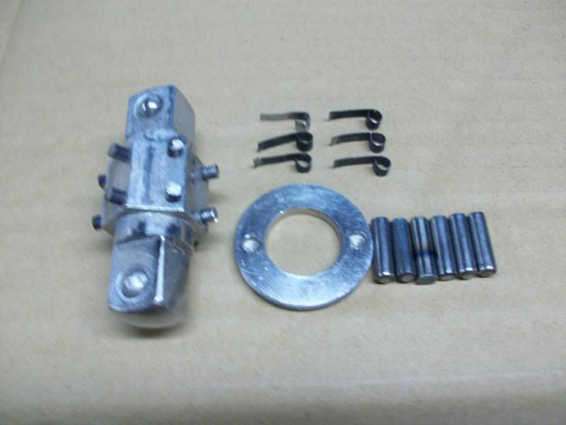

Sorry for the blur on these pics, but they are all I have on my computer and I am not going to take the ratchet apart again right now to get fresh shots.

Here are a couple more pics of the item I posted before. One is blurry, one is clear.

Thanks, I'm starting to understand it now. Does that style have a low torque limit? Seems like it would slip a lot.
I'm not sure. It does slip, but I believe that is because one of the metal "springs" is homemade. But, maybe I am wrong.
When I obtain a second example of the ratchet, I will be able to see if it also slips.
not sure if it's the same mechanism that was in my old sydchrome gearless, but if it is, they definately do NOT have a low torque limit. it was my "abused" ratchet for years, before i knew what a breaker bar was... used it with a BIG cheater pipe to SNAP the control arms off a nissan patrol...
