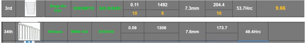

Choice made! TLDR - Bought USA Williams
Please stop spreading the ideal that Williams is relabled snap-on. That's simply not a smart take with hardline goods like wrenches, sockets, etc.
Snapon has higher hardnes, higher quality steels, uses unique and higher quality broaching hardware, and changes it out more frequently (for better tolerances). There is loads of testing out there on "corporate cousins" where the results confound those believe they these are just re-labels of the same underlying good.
Snap on vs Williams Wrenches = ∆4pts higher HRC
Heres AvE 's review of williams 1/4 drive USA sockets...on you tube
"Williams; Yard sale kwality at Proto prices"
Yowza. Those socket sets are all sorts of messed up
But it is relabeled Snap-on in regards to sockets. We have even had reps on here saying they are made in the same shop with the same materials and on the same line. It’s why you always end up with a hodgepodge of sockets like AvE did. CAT/Williams/Snap-on are all made to the same standard at the same place by the same people. The main distributor literally said Snap-on sockets go through more finish work but that is the sole difference.
As far as wrenches, ratchets, and other hand tools, you are correct. Williams has their own distinct stuff. But we are talking sockets (though if I had to take a guess their SAE bit sockets and the chrome extensions are the same from my experiences).
How is comparing different wrenches relevant to comparing these sockets? It is quite obvious Snap On FD+ are totally different to the super combos.
The sockets are not. The silly youtube guy isn't actually saying anything either, except it seems he is claiming he got a bunch of different sockets in the same packaging. If he got Snap On and CAT along the Williams ones in what he ordered, there's even more reason to assume they're all the same.
We know they are not as hard, so maybe that’s part of what he heard regarding “finishing” (fair enough- I think that’s a reasonable thing to think).
That is not established. Who or what proves Williams sockets are not as hard? Even if the steels were different, the hardness can be exactly the same with different steels. Did anyone do an accurate test? With that I mean - actually cut one in half, polished it up and did a Vickers test. The differences are probably too small to distinguish them with a Rockwell test at all (if someone did it).
My GUESS is, assuming a piece of tooling like a broach, produces good tools for 10,000 units, they run it for 20,000. First 10k get Snap On branding, last 10 becomes Williams. When they get to abrasives, same story.
Just hypothetically - Williams production gets in an order for a batch of Williams sockets, Bahco sockets and CAT sockets but no order of Snap On sockets at the moment. What happens if the tooling like the broach and the abrasives is just worn out at the moment (did 20000+ parts and needs to be replaced)?
As far as I know how manufacturing goes in such companies, they WILL NOT make a big series of Snap On sockets to keep on storage just because they replaced the tooling, and make those sockets until "the tool wears out a bit" and then start making different sockets with the worn out tooling. That's just very silly in my opinion. The production plan for making Williams sockets does not have a step that would say "wait until the snap on broach is worn out just right".
What they do is they order a new broach (or take one from the spare parts storage) and make the sockets with the new tool.
If the same sockets are made on the same machine - how likely is it that the broach tool is different? How much does the cost to make the tooling change? Is it cheaper for them to order 2, 3 or 4 different broaches for the 4 brands to make the same sockets in those 4 "tolerance classes"?
Probably not, it is even cheaper to order 10 same broaches and save money with using the exact same tool for all of them. The possibly minor tolerance difference would not be meaningful at all in the cost of manufacturing the tools. It does make production planning a big headache. Instead of having a machine that does the 19mm broach, they would then have a machine that does a 19mm Snap On broach and would need to be retooled into a machine that makes a 19mm Williams broach. That re-tooling downtime is not worth it. The more precise Snap On broach would never cost twice as much to manufacture - and even if it did, the downtime for re-tooling and production planning would not be worth it.
You either have no idea what you are talking about or who you are talking to LOL...
There are plenty of examples of brittle HRC 55+ (King ****) tools and well performing mid-40s (proto), that's not really the point. Hazet is mid 40s hardness and they are very good tools, its just their companies style that they use matte crhom and middle-hardnesses. Snap on typically 50+ HRC in sockets and wrenches, they have a unique feel to them.
But in no way are two lines with 5 HRC points using the same steel/post processing....no way jose not happening.
This is true whether you like their wrenches or sockets or not. As I said earlier, I'm not a huge fan of snappy 1/4 shallows myself...I prefer other sockets to snap on....but... I DO prefer snap on's steel quality to anyone else....and you can definitely tell the difference.
I would be the first person buying up off-label stuff if they were using the same quality steel, since that's about 95% of the reason to buy snap-on (even when you don't love the designs).
Its the same reason many people like snap-on breaker bars...and pry bars...when the ony thing between you and a trip to the ER is steel quality...smart people pick steel quality over doctor bills.
But know my tools pretty well at this piont, and if you know your tools...like inside and out... nobody is sitting there saying A and B are the same when they are not. If you go on ebay, people are selling CAT for like snap-on prices, like 2-3x what they are selling williams for.
Nobody is buying williams and thinking its snap-on, except for the times where its very well documented they are both re-labeling the same 3rd party suppliers or using older snap-on designs (like hard-handles and 936 ratchets, and the older ratcheting wrenches..or whatever).
There is no "truck tool equivalents" thread with 20 years of reports where professionals sit there and say snap on and williams sockets are the same...LOL
Your answer is "mechanics know". My experience tells me mechanics can be a very superstitious lot so that argument does not convince me in the slightest...
Also, still have no idea what you mean to tell with the second and third paragraph. How does comparing wrenches probably made on totally different product lines prove that sockets made on the same product line are different? Does comparing Taiwanese Williams sockets to Snap On sockets suddenly mean the USA Williams sockets are also worse?
You can reach 50 HRc with a ton of completely different steels. Again, not sure what you're trying to convey.
Unless someone actually performed tests of both sockets, I hold your statements in very low regard. You are not going to "feel the steel" difference between Williams and Snap On. Try saying that out loud and you might realize how silly that sounds :)
Someone has actually done hardness testing of both sockets. That’s what I’ve been saying. And as I recall, not close.
@F-22: you know all this. When you pull on a ratchet handle with any load, your tools, everything between your hand and that fastener winds up. Snap on tools are generally stiffer. You get used to moving your ratchet a certain amount, for a given load. It’s a Hooke’s Law thing. If you are working on airplanes, spending a lot of time with torque wrenches, you’re gonna feel the difference. If T-45 says he can feel the difference, I believe him.
I'd say it's actually quite well documented that the williams usa and snap on sockets are the same. The exact same manufacturing plant and same dimensions and even videos of the production exist. The only other argument is snap on dumps a ton of money into using just a tiny bit different steel that's better than williams but there's no real way to prove it.
No, opposite. Well documented that they are NOT dimensionally the same. They outwardly look alike which fools YouTube people. But checked with a caliper, not the same.
My guess is it’s the exact same steel. The original toolsdelivered thread on this subject is findable and what was told to him was chroming and finishing (I think grinding, polishing, all fit into this) and there was talk about heat treating in there IIRC. Imagine heat treating tons of tools everyday and just controlling the quench temperature, which as you know effects hardness. Maybe Williams sockets go in with the pliers, I don’t know.
Guys: don’t want to be rude, but don’t want to spend time on a subject that’s already been discussed, on a subject people don’t care enough about to start a proper thread for and collect all the data. Every 5 yrs or so this gets discussed in the wrong threads and we keep having this discussion with the newbies. And obviously, if you think Williams is Snap on just cheaper, bless your heart. Not trying to discourage anyone from buying Williams.
You guys are talking past each other a bit.
I don't have enough caffeine in me yet to go back and forensically read the exchange, but I do recall thinking that comparing wrenches made in two different lines wasn't really the point. No-one has presented any data on the HRC of Williams or SO sockets. The AvE video (like so many of his these days) was utterly useless. I'd love to see TTC do soocket
In TTC wrench tests, there are three wrenches that come from the same ODM and have the same head design/AS/etc. - Carlyle, Icon and Milwaukee (lengths are different and Milwaukee has a more-decorative shaft design). The Carlyle has by far the highest HRC (58.2). where the Icon and Milwaukee have 46.2 and 49, respectively. All of them performed very similarly on the psi test (1465, 1495 and 1492). Their rankings are currently #5, #6 and #14 with ratings of 9.66 for Carlyle (same as SO FD+), 9.33 for Icon and 8.33 for Milwaukee.
All three are made in the same factory and presumably on the same lines. All produce a similar amount of psi in the test, despite the top two having significantly-different HRC ratings.
One of my conclusions from looking at their test information (they can't account for sample variation, etc. so it can't really be called data) was that HRC wasn't as much a factor as overall design, and even low clearance tolerances didn't really make a big difference in psi generated. The Wright broke the bolt with a pretty-poor 0.17 tolerance just like the#1-rated Mac did at 0.09. :dunno:
Based on what I saw in the test, I chose Icon for the best bang for the buck, and they've been great so far.
I'd love the see TTC do similar testing for sockets. Over the holidays I'm going to do some comparison across my SO, Icon, SK, Tekton, Sunex and Ko-ken sets, but I admit right up front it will have to be considered a subjective exercise - I'm not a test engineer.
You keep citing testing and information, but you don't link to it or post it. That relegates your posts back to opinion.
