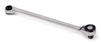

I find myself frequently encountering tight situations where I need to get a 1/4" hex bit in a small space but I can't get them there via a screwdriver-type driver. I need something more 90 degree-ish that can ratchet.
I found this Mac one that looks pretty cool. Double flex end, flat handle, very compact: https://www.mactools.com/products/s...3jdltDL_NR1XVHnlyalFJqiOVQcjY83rNbIUTXIdDQAxU
What's important to me if the clearance between where the bit sits and where the end of the ratchet head is (see picture). Looks like Matco makes a ratchet that's pretty small as well but it's a little bigger than the Mac one. Problem is, the Mac one is $85. Anyone know of an alternative? Anyone own the Mac one and can comment on it's quality?

I really like the look of the MAC because of the double flex head, makes me think it might get into some really interesting places.

I can't imagine trying to keep a Phillips bit from camming out with that flex head

That MAC unit mentioned in the first post is close, but is it reversible?
And it doesn't have the super-short handle that seems to be required in some instances.
And it's an $82 price point.
