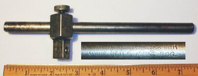

Hi KnurledNut. I'm a vintage (30s, 40s) only guy, and I can tell you it was a very rare feature in that era in the midget drive sizes for some reason. (Just as rare as captive detent balls to retain crossbars in hinge handles, a subject I deep dove into recently on the thread 4.c linked above.) Many major mfgrs eschewed the idea, including Snap-on, Williams, and New Britain. (The Craftsman you guys are citing must be MDF era =V= or later.)
Out of dozens of sets I have, these are the only Sliding Tees I have with a center detent ball groove.
The top two are 9/32-drive, so outside your query. They're both wartime Navy spec sets. The bottom two are 1/4-drive.
Philadelphia Mfg. Co. (no model #)
Walden-Worcester 39120-20
Walden-Worcester 7370
Armstrong Armaloy NM-20A

Lots of good info. And thanks for the picture. I did notice Walden made a 1/2 drive with a thumbscrew that would be great to have in a 1/4 version! Someone should produce one with that feature. From AA:
