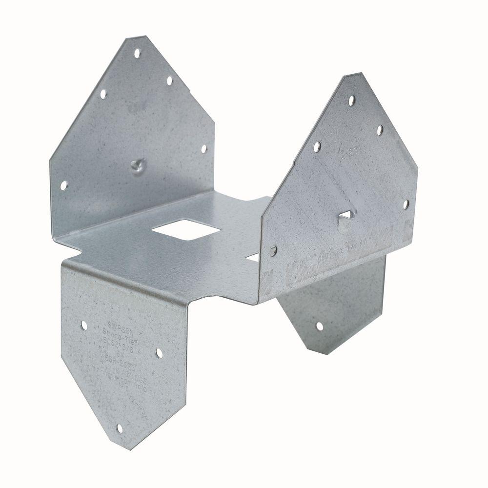

I know it was common practice forever, but I'd recommend against notching your posts to support the beam (if that's what you've shown, kind of hard to tell). The cut weakens the post, and creates a pocket of sorts to hold moisture. I've used Simpson Strong tie post-to-beam connectors on a couple decks and really like them.

Also, I don't like your beam design, this is the way to do it:

ItsNemo- appreciate the reply. On your post to beam connections do the outside "strap" pieces remain in place? I like the look of it!
I'm laying out a new design in sketchup now. I'll build it with 12" OC
Yes, those outside pieces of the post/beam connection remained in place. They are bolted through with several 1/2" galvanized carriage bolts each, 4 for most, but 6 in the middle two posts where the two pieces of beam meet. The beams are three 2x10's with 1/2" plywood sandwiched between the layers to get it out to 5.5 inches thick like the posts. All the layers are glued with PL Premium and nailed on 12" centers. You'll notice a gap in the plywood in each beam in the pic below when they're sitting on the ground...once hoisted in place, I slotted in additional chunks of plywood and using extra long nails, nailed them in to "join" the beams together a bit better.
