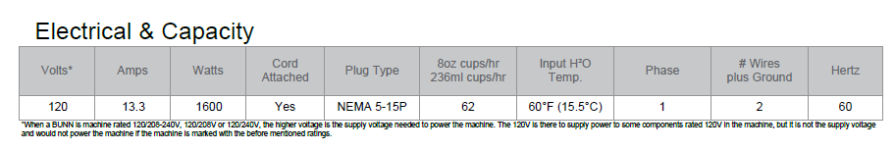

The monitor and receiver should be negligible. How many amps does the coffee maker draw ? Move it to the kitchen ? What kind of lights ?
Coffee maker (Bunn) draws 13.3 amps and is in the kitchen whose particular receptacle shares with the living room. Lights are ordinary lamps with LED bulbs.
micrometer
Dec 24, 2025
17
Rocky Mountains
You sure about that? 1600w for a coffee maker is a lot.
I'd start with a new coffee pot
This coffee maker is commercial grade and we're keeping it (maybe move it to another kitchen receptacle off the living room circuit). My island has a receptacle (that shares the living room circuit) that trips the breaker when all other draws are running (it's the last straw that trips the breaker). I think my best option is to find another circuit for this receptacle.

If the coffee maker is drawing 13.3 amps then you are definite pushing the limit. The monitor is probably an amp as is the receiver. Add the lights and you are over the top. Smaller coffee maker maybe if you must have one ? Only choice I see is to add a circuit. Easy to say, probably not that easy to do unless you have an open basement or easy access attic.

A 13.3a load on a 15a circuit leaves only 1.7a for all of the misc stuff plugged in. All is working as expected. No surprise or concern.
Move the coffee maker to the small appliance branch circuit in kitchen/dining room or add a circuit for it in the living room.

The Bunn coffee makers I'm familiar with keep a tank of water hot 24/7 so they are ready to brew quickly at any time. Nice units until the immersion heater burns out from continuous use.
