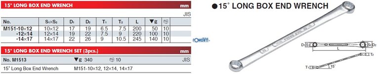

15 degree offset DBEs in metric?
lardy1
Mar 17, 2019
3,426
I have some nice lengthy ones in SAE but don't see a lot in the places I've looked for metrics. Snap-On has nice ten degree but just not even a chance I can justify that cost.
These will be for home shop use. Suggestions?

Proto or Blackhawk on EBAY. May have more than 15 degree offset but, the Protos are finished very nicely.
Capri and Genius have really nice, long pattern DBE wrench sets but, they're zero offset. Great for reach and applying extra umph.

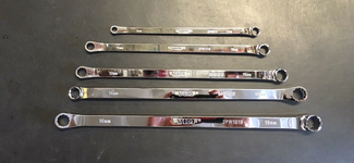

VIM DPW100. These are extra-long. Skips 9 and 18.
I dont have them, but I would consider if I needed a set.
Could be had for around $100 if the cards are played right.

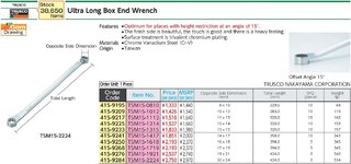

Amazon has a Wright 13 x 15mm for about $27. Not chrome plated though.

There was a thread on this a few months ago, specifically looking for a Snap On substitute. After looking at all of the options in the thread, I went with the Stahlwille 23 linked above. There are all sorts of options for long 0* DBE, but OP specifically said 15*. Yes, the Stahlwilles are 10*, but that's closer to 15 than 0.

I have the VIM drain plug wrench set. They are unique in that it's not just boxed end that's angled but, an inch or two back is angled. They're at work so, I can't show you what I mean. Really nice wrenches :thumbup:
