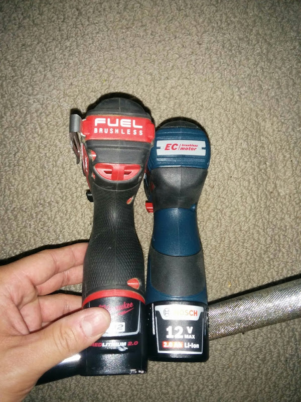

rice rocket
Mar 24, 2011
3,175
The Bosch stuff is great, I actually switched out most my M12 for Bosch 12v, and I'll be picking up more brushless as they (slowly) revamp their lineup. It's not as powerful as the M12 (I'd say the brushless ones are just about as powerful as the M12 brushed), but they're about half the size and weight of the M12 (okay exaggerating a little).
If you want a truly small tool that punches above it's weight, get the Bosch. If you want a tool that's borderline 18v tool, then get the M12. The M12 has options with circ saws, bandsaws, etc. as well, but that concept to me is foreign anyways. For someone who has both 18v and 12v as well, I appreciate how well the Bosch tools perform for their size.
The weight difference is 1.6 lbs for the Bosch PS22, and 2.7 lbs for the Milwaukee 2602 (my 18v Metabo brushless is 3.25 lbs with the compact battery).
The size difference isn't as dramatic, but still significant. The balance is also not great on the M12 Fuel stuff (since that extra 1+ lbs sits high up on the head, you really need the 4.0Ah battery to balance it out but pushes the 2602 above 3 lbs...which I'd rather not lug around all day when I have a pile of 2.0Ah batteries).
EhHVZBnSLQpazmv08wjavJHCInfyj_DRQ6D4fE8Q4UhP=s800
The only things I prefer on the M12 are the grip, which is slightly narrower, and the single handed bit insertion on the bit holder, which I have no idea why Bosch didn't include. In the end though, I don't swap bits that often, so it's a small price to pay for a better balanced, smaller, much lighter tool.
Unfortunately, Bosch has been slow revamping their 12v lineup. The brushless impact, a 12v brushless screwgun, and a new little 3 lb jigsaw were released in Europe this year, but not here.
