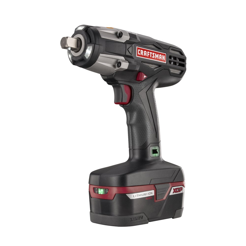

If you are going C3 it might be worth considering the newer HD 1/2" torque wrench, it is 300 ft-lbs vs. 200 for the older model, picked one up on sale for $150 and like it, came with a 4 ah XCP battery and a charger, spins lug nuts off FAST.
A smaller 12V 1/4 hex drive impact driver is well worth having too, the lower weight and size is a big advantage for smaller fasteners and is much less likely to overtorque them, use mine constantly for mechanical work on cars, motorcycles, etc.
http://ecx.images-amazon.com/images/I/51I3A%2B2Lp%2BL._SL1000_.jpg[IMG][/QUOTE]
I recently picked up this newer model on sale for $150 with the 4ah battery. Very impressed for the price (and it uses the same batteries as the 19.2 (pre C3) tools I got 12 years ago for Christmas from my dad).
I recently used it to remove/replace all 32 165ft*lb lugs on my F250, along with all the bolts/nuts needed to swap out the front shocks, replace the ball joints, etc, and rotate two other sets of tires on two of our other cars all on one charge.
