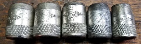

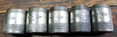

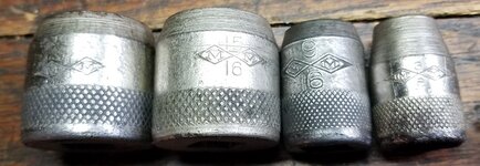

Here are all the sockets in my set, top two rows are hex, bottom row is square.
As I said, to me, there are some differences in the knurling patterns, but not what I would call drastic.
You can have fun trying to characterize them and compare to yours. I'm not sure I have a keen enough eye. I am not sure it's not just a function of the same die, different roll stamping machine, and different operator, or slight variations of either of those factors producing different implementations (deeper, etc), but if I was forced to study the shapes formed between the intersections of the crosshatched lines, gun to my head, here they are in the groups I see.
These look much more like blobs, squashed ovals or dots than diamonds.
These look like true diamonds.
And these look like skinnier diamonds, I guess, but not so different from those above.
