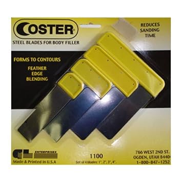

Hi Joe,
Great work on the 53. What kind of paint stripper are you using? Just curious as to the tricks you have learned for the proper way to strip vertical surfaces.
Thanks
There is only one paint stripper worth a darn in my opinion and thats Aircraft Paint remover from Kleen Strip.
I have a small metal pan I pour it into and brush it on with a 2 or 3 inch throw away brush. Two of the biggest tips I can give is get the surface good and saturated and keep it wet. Also patience is key...let it work. If whatever your stripping has multiple layers of paint I will usually apply 2 or 3 coats of stripper giving it plenty of time to soak in between coats. To scrape it off I have found that metal body filler applicators do a pretty good job and they're easy to clean up when your done.
After I'm done with a panel I always follow with a water rise and use a blow off gun to get it dry. I usually also wipe the panel off with lacquer thinner on a rag then move onto whatever surface prep it needs.
