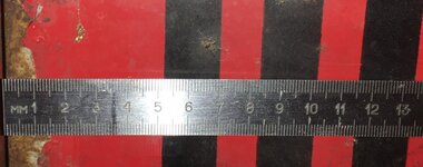

I was able to sneak in about 10 minutes of time with the rover today. I decided that I can quickly get a template made for the triple black stripes but it turned out to be a little more difficult than I thought.
Let's start with the easy measurement, which is where the bottom line begins. It's 2 1/8th inches from the bottom of the box. This was dead on all the way around so I'm happy with that one.
The next easiest measurement is the gap between the three stripes. All of them are 1/2 inch apart and this also is dead on all the way around the box.
Now, the measurement that proved a bit more troublesome to nail down is the actual thickness. The stripes have endured more than 80s years of shop use. The stripes have nicks and cuts which led me to measure the widest stripe point of 5/8ths. There was one spot that seemed to be 11/16ths though. This bothers me.
The stripes should go all the way around to the spot where someone added the homemade panel in the back. This of course will be removed and all holes will be plug welded.
Now, if you're paying close attention to picture #1, you can see that somewhere along the line, the castors were welded. Initial inspection tells me that the person who performed the welding was actually skilled and knew how to weld. I have no fear of them breaking. What I don't know is if the casters are original or not. It has Noelting-Faultless Evansville, IN No. 20 Plaskite swivel castors all the way around. I know these are vintage and rated for industrial use but I have no idea of they are originals.
Here is where I hope that one of you other rover owners can help me out. Can you confirm the triple stripe measurements and if these casters are originals? Any help would be much appreciated.

FJ 432
Aug 2, 2010
3,748
Littleton Colorado
Horse,
I realize that my bottom is not a Rover and my guess is a little newer. Similar to the catalog drawing my bottom stripe begins at 2" with each stripe consistant at 3/4" wide with a 1/2" break between stripes.
My casters were added by the PO so no help there.
Can't help here with your actual request, but may as well throw in an observation, a possible explanation, to try and help you feel less bothered.... It looks to me like whoever originally applied the stripes used 1/2" wide masking tape between the stripes. This gives the precise and consistent measurement you observe between the stripes. He didn't bother to be accurate when he stuck it on, and didn't get the lines of tape precisely parallel, so the width of the black stripes vary slightly... I suppose it looked OK like that and didn't bother anyone until you measured it! Now I'm awake at 3am and it bothered me too..
The stripes are factory applied. However, upon closer inspection later in the day, I did discover that somewhere along the road the stripes were touched up in some areas by a less than precise painter. Now I feel much better knowing that the factory didn't half *** the stripes. Unless another rover owner chimes in with a different stripe width from "5/8ths, that will be what a lay down at the end of our adventure.

Ahh, here we go with our first 3/4" measurement. Excellent. I was going to roll with 5/8ths but 3/4 was what my eyeball ruler concluded before I started messing with an actual ruler. :) Thank you for this info.
Thank you to everyone else who chimed in as well. All of you play a part in my junk mania.

Shelbylex
Jan 20, 2018
3,152
Here are coupe of pictures of the stripes in both metric and Imperial. I figured out, it's easier to make pictures: if you magnify them it will be more precise measurement than what I am getting with a flashlight and a ruler (plu it shows the paint - mine is probably original)Stripe2.jpgStripe3.jpgStripe4.jpg
Bolt distances are approximately 1 3/4 x 3 (approximate - I do not want to turn it upside down and measured from the top)
Please recheck your distances
I really appreciate the pictures and measurement information. Thanks to you and everyone else, I'm 100% set to re-stripe this rover when the time comes! :)
