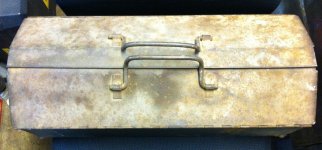

1940’s tool box restoration.. anyone able help me identify it?

Pt2 to follow.... not sure if all the effort will be worth it yet.

completely rusted out on the bottom. I wouldn't be surprised if after electrolysis there were holes in it.

Yeah it’s bad but pretty solid....going to try white vinegar on it next after getting all the paint off.

Thanks for the feedback AL. Yeah, I need a better workspace so having to make do at the moment.
The bottom doesn’t look too bad now on the outside.. the inside is bad though. I’m going to slosh it about in white vinegar for a few hours and see how that reduces the rust.
I don’t have a drill at the moment, but am looking to get one of the Milwaukee 18v cordless ones and I’ll use that with a wire wheel to finish off before a coat of olive drab.
I’ve also got an old dolly that I’ll use to knock some of the dents out.. although one lid is pretty badly warped so not yet sure how I’m going to straighten that.

Some progress..

Being it has corners braces you might be able to just replace the whole bottom with sheet metal. Depends on what you'll do with the box.
I had an older S-K box given to me that had one corner rusted out. I cut out the worst area with a dremel tool and made a "patch" out of galvanized and riveted it in. It will never be a beauty queen but it is usable. It holds my 1/2" drive Bonney sockets and several ratchets.

Pics look great d42jeep!
For the rusted bottom.. I’m not going to go crazy removing the rust - my plan is to get rid of all the loose debris and the use POR15. This should seal it up and I won’t risk blowing through it.
POR 15 45032 - 4oz Can Gloss Black Rust Preventative Paint - Paint Over Rust! (Single Can) https://www.amazon.com/dp/B00Q0I62IU/?tag=atomicindus08-20
It’s coming on now.. spent a few hours straightening the lids last night so it’s fitting better. A couple more times of going over and it’ll nearly be ready for paint.
Any tips on paint to get close to the colour of d42jeep’s box?
Looks like pretty decent repair.. I’m hoping I can avoid anything drastic with the bottom. More work on it and it seems pretty solid.

A bit of progress if anyone is still interested.. hopefully paint next weekend.. lots of time spent with the hammer and dolly to get out various bends and dents.

Personally, I'd use a hammered-finish paint. That would help cover some of the cancerous leftovers. And a light color - they seem to hide imperfections better than dark ones.
