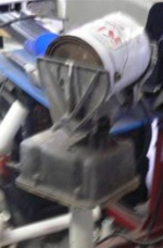

Just scored one of these on Facebook marketplace for $40.00. Works awesome. Solid unit however its's very dirty. Will need to get to cleaning it up one day. Can anyone tell what year it is by the serial #.? Would be nice to know the year. It's a cat. 30 model.

Here's one in so. FL $250 asking on CL. Dunno whose manufacture. Looks pneumatic.
Not too-clear.
