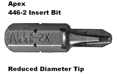

By hand or by power?
By hand, I like the #2 Phillips reduced diameter bits.
Both Apex and Zephyr make them.

I usually get my bits from the Snap-On guy. His first reaction is to had me the anti cam out bits and I tell him "no, I want the other ones" The other bits are a little more blunt on the tip and seem to fit deeper into the screw. They also last a lot longer. I'll buy all that he has on the truck at the time.
Wamsutta
Jan 8, 2014
10,891
Amarillo, Texas
Are those the reduced diameter #2 Phillips? Because that's the way they are; they go deeper into the screw.
