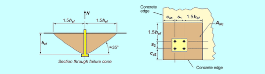

Could you share the diagram? The installer stated he has installed anchors in the middle of a control joint before. Keep in mind this is a well known installer for a well known lift company. I told him I’m not a structural engineer but under no circumstances would I think installing an anchor directly in a control joint would ever cross my mind. Are anchors safe to be reused?
Concrete, being strong in compression and weak in tension resists anchor pull-out forces through a stress cone radiating from the bottom of the anchor. (For a wedge anchor, this is where the wedge bites into the concrete.)
When a crack (there is a crack in - or one could develop in each control joint) passes through this stress cone, the shape resisting the force becomes part of a cone. The reduced surface area of the part-cone reduces the pull-out resistance.
When lift manufacturers design their baseplates, they take into account the anchor depth and the array of these cones:
I would ask him where he got his engineering degree from! lol I would also ask him for a printed copy of his company's insurance and liability policy and then enjoy the silence as he shuts up.
I would not re-use the anchors and am not sure how they would get the old ones out of the slab. If they were drilled properly, getting them out would be a destructive process. ... They might be worried about this and what you are going to say next.
Thank you thank you thank you! My concern is the same regarding reusing the anchors. But if he starts busting up concrete and I have to move the lift 2’ instead of just 10” to clear the holes then I’m closer to the wall then I want to be. Challanger has exceptions as to “abandoned anchors”. Basically cutting the heads off flush to ground see pic (rep sent it to me today when I made him mad)

Take a good 20240121_115253.jpglook at the attached pic. This crack control joint is doing its job perfectly, controlling the where the slab cracked. Your anchor is in a crack, and probably has only about 20% of its rated strength.
C
Cummins2014
Jan 24, 2024
37
Indiana
Take a good look at the attached pic. This crack control joint is doing its job perfectly, controlling the where the slab cracked. Your anchor is in a crack, and probably has only about 20% of its rated strength.
I agree completely. Essentially the lift is installed on 2 separate slabs (once the control joint finishes it's job) with 3 anchors, on each post roughly 2 1/2" away from the cut. When I spoke to the installer 20 min ago he still insists that I will have no issues leaving it where it is but that he would come out and move it if I like. I said yes it needs moved Challenger engineer said so. Installer has been very nice not sure if it's because he thinks he done something wrong or if that's just the kind of guy he is.

the concrete surface is a plane, its to keep the plate from moving, the weight of the car is a downforce, as long as the plate doesnt move, its find. so the control joint is not an issue if it hasnt move, or even if it hasnt crack through all the way. myself i would not do it either
