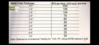

Looks like it’s just a 4% reduction in heat loss for an extra inch of closed cell foam going from 2 to 3 inches?

One thing I learned in stats class in college was to always pay attention to what the "reference" value is. In this case, the reference in that chart is a completely bare un-insulated wall which has an absurdly high heat loss. This really distorts the data.
But when you look at the actual test data on the right, 2.0" of foam has a 79 btu/hr loss (at given test size), and 3.0" has a 59 btu/hr loss. When switching the reference to the 2" of foam, we see that 3" of foam has a 25% reduction in heat loss compared to 2".
So whatever your heating/cooling costs would be with 2" of foam, they will be 25% lower with 3".
If that still doesn't make sense, let's put some values to it:
  • Let's someone has a giant completely uninsulated shop that costs $10000/year to air condition.
    • Going to 2" of spray foam will reduce your cooling costs to $1400/year
    • Going to 3" of spray foam will reduce your cooling costs to $1000/year
So for the guy who was paying $10k/year, any insulation at all will make a big difference, and the $400/year difference between 2" and 3" is meaningless compared to the nearly $9000/year he'll be saving. But for you, it isn't a no-insulation-vs-2" or no-insulation-vs-3" sort of thing. It's a 2" vs 3". In which case, you'd be going from a baseline of $1400/year to $1000/year, which is pretty significant.
For you, I think it the extra insulation would probably pay for itself in around 5-6 years, assuming you use the shop a lot.

There's liars, damn liars and then there are statisticians. I become extremely wary when percentages are bandied about.

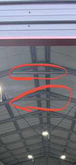

They definitely gave me 2"+ everywhere. On the ceiling there are areas I got 12"! Rest of it is at least 3.5" minimum..
On the peak area where the cross support is, there’s about 13” from support to roof. As you can see, it’s completely filled in.
Going to start a new post. I'll have more pictures on there. I do have other questions regarding the foam.
Hello, I'm in Orlando far east side, Who did your spray foam? looks very thick, thanks
