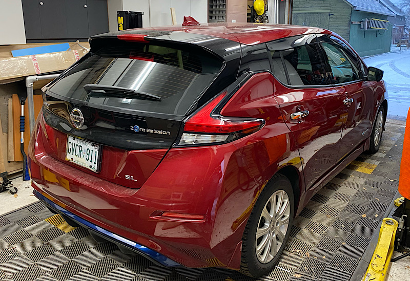

Denwood....Well....what kind of EV auto did you buy?
2018 Leaf SL..nothing **** but it works.
This is why you may want 50 amps to your shop. If you plan an EV anytime soon (and you should, cuz they're awesome), the EVSE power units (you plug the car in using them, but not all manufacturers/trim levels include them) will have 120V or 240V options. The Nissan OEM EVSE that came with my LEAF SL will add about 5 miles of range every hour at 120V@12 amps, or 35 miles of range every hour at 240V@28 amps. If you don't drive much, no problem. If you commute a lot, you'll likely want more juice.
You can also buy aftermarket EVSE units, so I've got one that will charge at 120V@16 amps, or 240V@16 amps. This works fine on my 30 amp feed, however at some point I may upgrade to 50 amps.
