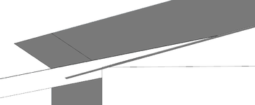

When you say to cut and align rafters atop trusses do you mean leave the roof sheeting (OSB in my case) and do the correct spacing for the lean-to span?
OR
Cut the roof sheeting to expose the trusses and match the rafter spacing with the trusses? The garage is 24" OC so I would need to #1 2x12s for that span.
Either option I'm picturing something like this:
Which doesn't seem right

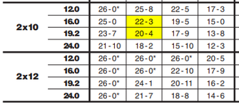

I think I cracked it! I took better measurements of the existing conditions. Garage rafters are 4:12 which bought me enough height to hide 2x10s without crazy long tails protruding into the truss space.
2:12 pitch on the lean-to: (I have height 2.5:12, maybe even 3:12, but then I need to extend the pitch change even further up the garage.)
Switched out to #1 2x10s @ 16 OC. The span is just over 240" so I could do 19.2 OC.
Close up of the top-plate birdsmouth detail:
