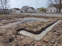

Finally some progress, builders showed up Monday and started the footings. Got them all dug, back filled with gravel where needed and have the concrete truck showing up tomorrow morning to pour the footings, of course if the rain holds off.
