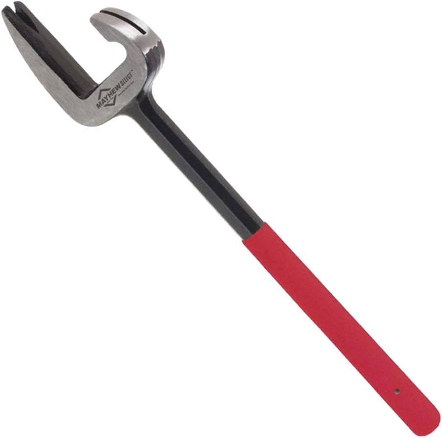

I am extremely choosy when picking out lumber because the job is so much easier with straight lumber. But sometimes you just have to deal with crooked stuff and this Tweaker bar comes in handy for twisted studs.
https://www.amazon.com/Mayhew-Select-41500-Tweaker-Multi-Use/dp/B0000224U8
I have something like this but smaller size about 2feet long for twisted lumber and general prying.
https://www.zoro.com/stanley-demoli...king-tool-55-099/i/G1347351/?recommended=true
