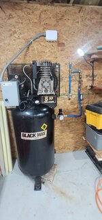

Im trying to come up with a plan to run my air lines in my new garage. 5hp 2 stage 80g Sanborn black max compressor. Right now I have a 3/4 regulator and a 3/4 jumper hose and cut off.
I figured I should just go all out and keep wverything 3/4 as I want to paint and sandblast. But looks like I cant find any 3/4 manifolds. The 3/4 rapidair kits look like the go from 3/4 to 1/2. At the manifold blocks. Not to mention I havent even seen a 3/4 air reel. Does it even matter? Should I just slap a 3/4 female to 1/2 reducer on my jump hose and ride off into the sunset? Why is it so hard to find 3/4 stuff20230812_191242.jpg

I decided to run 3/4 copper until the outlets and reduce as needed to 1/4 or 3/8, but I sized the main regulator and filter at 3/4. Probably overkill for a 1 man such shop, but it's the GJ way. I bought a whole mess of fittings and valves from Zoro with coupons.

Size for the largest simultaneous loads and distance. If only one tool will be used at a time, then pick the largest load....that could be your sandblaster.
Misc drops of of a 3/4 header could be 1/2"
You don't really want black pipe. Copper would be much better but $$. Pitch the header so it can drain to a low point.
Connect each drop to the topside of the header. At each drop, include a drip leg w/valve at floor level to drain if needed.
An air dryer (39F dew point) would provide one of the best benefits for all air usage.

I would suggest you plan your system so that you have 3/4" at the beginning of the system and tap your paint and sandblaster off the 3/4". Then reduce the rest of the system to 1/2" to the lighter loads.

3/4 mains 1/2 drops work great used this pdf on mine

33 years ago, I used 3/4" main line, 1/2" drops. Black pipe. Still working. Re using 2" pipe to increase air capacity. I respectfully suggest that if you need more storage capacify, add another tank.

I agree. Unless you have a lot of air use, and I mean over 20 CFM, 3/4" is plenty!

The short answer is YES, it is worth it
I like the 2 inch main line line idea
Fed by 3/4. or even 1 inch, it will provide storage as well as surge protection

How much 2" have you cut an threaded, plus paid for? The big stuff is a pain to cut, thread and hang, plus expensive in comparison, plus you don't get that much capacity, about 1.6 gallons per ten feet, so not really that much. So you have a 30 foot long shop and run 2" down the middle. You just added less than 5 gallons of air capacity. A 2x2x3/4" tee is $12-$13, then the pipe is $100 per 20 feet. That 30 feet of pipe with 6 drops just cost you $250, plus the extra work of muscling 2" pipe and fittings together. I have done it, it ain't fun.
Plus 3/4" pipe will flow a ton of CFM, more than most of us would ever use. Run it in 3/4" and if you want extra capacity buy a 5 gallon air tank.
Depending on the shop layout, say you want drops on both walls, you may want to run a continuous loop of 3/4" pipe. You will double your flow.

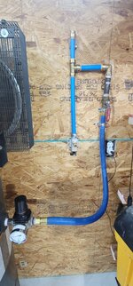

Xkylescorex
Jan 10, 2016
160
Thanks for the advice guys. Here is my current setup. 3/4 pex, the joints are home depot sharkbites. After replacing my pressure switch and check valve and doing an oil change, everything is air tight. The pipe going up with a dead end cap on it will go to the ceiling and over to a hose reel once I buy one. Hopefully in a week or two. Trying to find a used sandblasting cabinet now.
