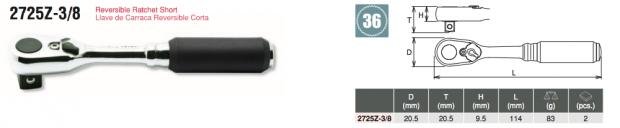

Wright 3430:
45 teeth
Head dia. 27/32 = 0.8438" or 21.4313mm
Head depth (inc. selector) .523" or 13.2842mm
Total length 4.73" or 120.142mm
If you are going for the most compact, The Koken I mention above is a bit smaller than the Wright in every dimension...

Koken 2749ps is probably the best option other than the Wright: if you really want the Wright, Damar will get one for you but it might take some time. Or you could use Amazon.com
Nice ratchet, but his is just a stubby 3/8 not a 3/8-1/4. Aside from total length, this one is larger in every respect compared to the 2725Z, and it has 24T vs 36T
Actually, that is the 1/4 stubby with a 3/8 drive square. The stubby 3/8 is part number 3749ps. But it does have 24 t.....

If that Koken is sold as a 3/8" in a 1/4" body, then that's just craptacular. That head is enormous, and would be even worse as a 1/4" drive.
