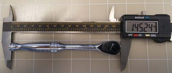

Folks,
Apologies for the hot linked images. Google is not very friendly about hot linking pictures.
Please see attached pictures for dimensional measurements.
Overall length: 145.24 mm
Head width: 19.82 mm
Head thickness: 9.43 mm
Mike
