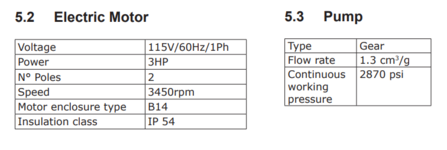

I don't have the lift yet but this is the info from the manual.

That nameplate is really something, 3hp on 120 volts...
It really shouldn't even run on a 30a circuit let alone a 20A. Electrical code would tell you that motor needs a 50A circuit.
Why do they build **** like this?
I get guys all the time that want a regular 120v cord on a 2hp sweep auger. If they won't listen then they find out themselves that it's going to trip a 20A breaker.

I'm not a licensed electrician but this is how I see it....
3hp X 746 = 2238 watts
2238 watts ÷ 120 volts = 18.65 amps.
I don't believe it's considered a continuous load so it SHOULD work on a 20amp breaker..... but I'd probably run 10 gauge wire with a 30 amp breaker, along with a 30 amp plug and receptacle. (or hard wired)
Again, I'm not a Sparky.... one of those guys will stop by here eventually and set us all straight. lolol.
A demo lift will run all day on a 15 amp circuit without a car on it.
Motor efficiency assume 85% = 18.65/.85 = 22A, Starting current ~ 3 times that = ~ 66 amps. I'm not a sparky either but I do know a few things.
I recommend wiring with 10ga on a dedicated 30A circuit.
Strange that the motor has a HP rating but not a current or service factor. But my Shop Vac vacuum cleaner says 6.25HP and runs all day on a 15 amp 120V circuit.

Whats the FLA rating on the nameplate? If 17a or less then its 3hp or less based on NEC motor FLC table specs.

What is the FLA rating on the nameplate?
3HP is 17a FLC so its not surprising that a 2.5hp will work, though 2.5hp is not a standard HP rating
EDIT: wrong values. was thinking of 240v. a 2hp 120v motor has a 24a FLC. so 20a for 2.5hp @ 120v is a bit off.
