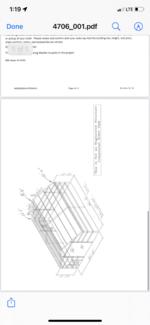

I would like to do all of it myself as well, other than the concrete. Was putting the building up difficult? Do you have prior experience with this sort of thing?
Has anyone heard of Big Buildings Direct? They have a 28x40 that looks to have two rollup doors, a man door, and a few windows for just under $18k, installed. Seems like a good deal.

Thanks for all the info. I've been continuing to do research, and Mueller seems to be the most cost-effective. I've got a quote for a 30x40x12 with 3" vinyl insulation, one 10'x'10' overhead door, and one 3'x7' walk in door for $18,491 (base kit was $14,195 for my wind and snow load). add in concrete and I'm probably looking at around $23,000 to get the building up. Seems like a pretty good deal to me!
I did a little more comparison to the Big Buildings Direct building and I definitely didn't like that it was tube instead of red iron, but it was attractive at first that it was just under $18,000 installed. But by the time you add in the insulation and doors that came with the Mueller building and not with this building, Big Buildings Direct was about $5,000 more expensive, which is probably similar to how much it would cost me to have someone put it up. I would like to put this one up myself though, so Mueller seems like the choice. It'll be a while until I actually have the money together to start the project, but it's nice to get some of this research out of the way.
