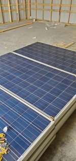

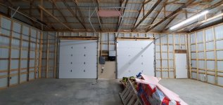

Some updates.
Garage doors installed.
Solar installed--way easier then I thought and cheap if DIY string inverter. I have under $3,000 in my solar, between use ebay panels and 7.7kw SMA Sunny Boy inverter. This system powers 100% of my house and shop 10 months a year so ROI is under 3 years!
I've installed LED lights and finishing electrical then spray foam, mini split, and drywall interior. It's coming along.

Sure, here is a link to some: https://www.ebay.com/itm/Solar-Pane...mpid:PL_CLK|clp:2334524&LH_ItemCondition=3000.
I bought from this seller but a different smaller cheaper panel. Basically just look for used panels on ebay and purchase what your budget allows. I'm not a "green" person but I'm very fiscally responsible so solar with sub 36month ROI made sense to me, not to mention 26% tax credit, which keeps going down over the next few years before going away.
