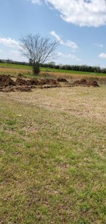

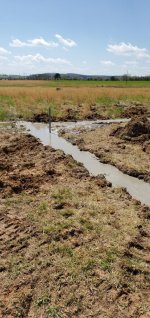

Here is the build site.

All that has to be removed down to untouched soil. Then fill brought in. Mine was two freaking feet. Must have been a farm. Concrete is all about the ground prep

Concrete come out today to start footers. The ground he is too wet to keep going. Ended up paying for a gravel drive, so that's $1,500 for gravel which is unexpected. Also rain this entire weekend so concrete may not get finished until Monday.
Pretty bummed about the delays.

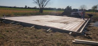

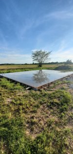

Finally progress! We literally have had nothing but rain for the past 50 days. Here is the concrete!
