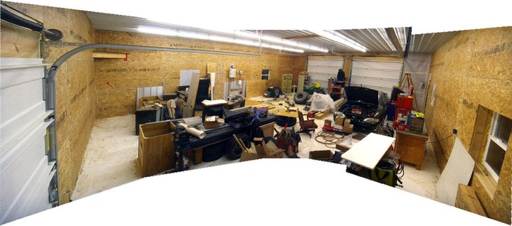

Long time with no updates...
I finished insulating and put up OSB:
Then painted with Killz and put up some old kitchen cabinets, some old mirrors, tv, counter & sink - all of which I have collected for free over the years!
Here's a pic I took before I threw a garage party a few weeks ago.
It's turning out exactly how I wanted, 3/4 garage and 1/4 man cave = good place to hang out and get stuff done.

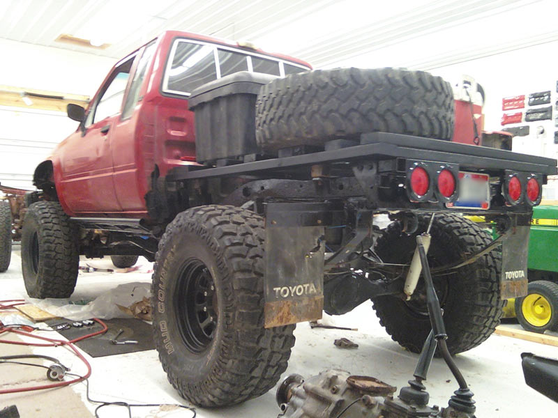

I fixed the frame on my 85 yota and got the 86 motor in it, then parted out the 86.
Got the 85 ready to do some offroading in Wellsville, OH:
