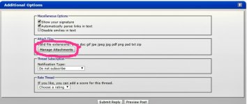

You can post up to 7 pictures from your files at a time using this method. The pictures will display as clickable thumbnails. Start by clicking on the "Go Advanced" button.
