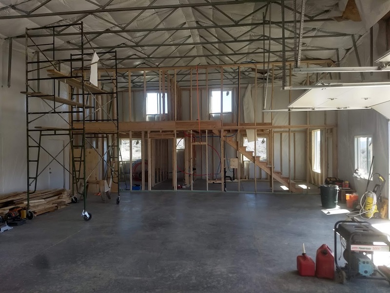

Hi All,
Wanted to share my build and a bit of an introduction. I'm a long time lurker on the forum but have not posted much. I'm an engineer by trade turned entrepreneur. I resigned from my day job to do design work and machine work from home. I outgrew my 3 car garage so we bought 4 acres in a more rural area and am building a house and detached workshop. The biggest headache was financing and permitting. I got my grading permit spring 2018 and building permit that summer. Financing didn't come until October. I'm not using a GC doing all the work I can only subbing out things I can't like large concrete pours. Not using a GC is a major headache with the banks but I finally got it done.
Here is an aerial view of where it is being built before I started.
https://scontent-dfw5-1.**.fbcdn.net/v/t1.0-9/51353653_10101639702590058_8554318120431386624_n.jpg?_nc_cat=110&_nc_ht=scontent-dfw5-1.**&oh=c7e929c5280d6a0e78148231b377d476&oe=5CF728FA
My brother took some cool aerial shots with his quad copter when I was in the process of grading it.
Here is a draft of the floor plan. The last 14' is going to be an "apartment" I'll be living in while I build my main house. When the house is done I'll keep it as a guest house but if I ever need more shop space I could always tear it out.

Right not I have the frame for the shop done and am working on sheeting it. Here are some pics after grading but before breaking ground on the foundation up through framing the building.

I had done a fair amount of the side sheeting by myself but it was not easy. I got some help to do all of the roof sheeting and roof insulation so we could get it knocked out in a few days. We finished the last panel on Saturday last week. There were some light snow flurries on and off during the day so we had to take a few breaks and wipe off the panels with towels a few times so we wouldn't slip and fall but we got it done. The next day I went out and put on the ridge cap trim. It started snowing about half way through so I had to keep a towel with me everywhere I went on the roof to wipe off a path to step. We got a light snow three inches or so this Monday before I finished getting the overhead doors in. Tuesday and Wednesday I managed to get the last of the overhead doors in. Good thing I got the building dried in when I did because we got a big storm here that hit Wednesday night.
I measured 15" on the ground outside the shop yesterday. My guess is we got about 18"-20" in two days which is a lot for this area. I have been living here for five years and the most I have seen at once was probably less than 6". I heard the last storm that wasn't even this big was back in 80s. I have 35" mud tires on my 4x4 and good thing too. Some of the drifts on the road and my driveway were probably closer to 2' or more. Someone else stuck their 4x4 truck with highway tires and he had to leave it and get some snow chains to get it out.

Yes just in time. What a relief too. Even with a big storm like this here worst case scenario you wait at home a couple of days with a big blanket and clean out the pantry. Next up is insulating the side walls and framing the interior rooms so I can live in it. I went and got the lumber before it snowed. I hope to be moved in around April so I can get to building my house.

It is going slow but steady. I have a few more pieces of trim on the exterior I need to get to but for the most part the steel portion of the building is done. I am happy to be finished with the the insulation. I am finishing up the electrical and plumbing this week..

Nothing right now as I'm busy building the main house but I had been doing a lot of one-offs and prototype work. I also offer design services. I have a CNC knee mill, manual lathe, and welders etc. I resigned from my engineering job a few years ago to try and fulfill my dream of making a rotary valve engine and it morphed into a machining business. After I started getting some traction I felt I outgrew the garage so I decided to build the new shop. I hope to get back to the rotary valve project and machining jobs next year when the house is done.
Impressive. I like the look of the inside and the way you are setting it out.
