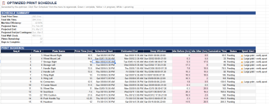

Well this was a fun rabbit hole and distraction from work(don't tell the bosses)
I gave AI a prompt for this (Claude paid version on Opus 4.6) and let it "cook" as the kids say after a bit of back and forth on inputs/outputs, etc....it had a very good handle on the expectations with minimal prompts. I told it to build in Google Sheets for hopefully easier compatibility and not requiring Excel VBA macros. I also went ahead and loaded the build plate details for the published .4mm layer height/256mm build plate version of the chair into it:

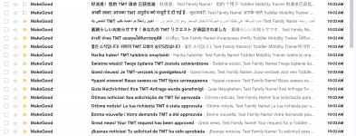

Load in some specific details the machine(s), it also has (untested yet) ability to send you email reminders lol

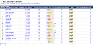

Information on the build plates required:
Details on swap windows and any special available/unavailable:
Then after running the Print Scheduler Script it kicks out a schedule
That schedule is the initial result on the first run....it had some bugs but for generating 883 lines of code I'm pretty impressed
Dropped some screenshots back into Claude and provided some feedback on the bugs I was seeing and let it go...about 3 minutes later it had a fresh batch of code to copy/paste in....about 200 lines longer this time. Hit the Run Scheduler button and see this for a a bit
Took about a minute and got this message, I told it 2 printers for this run:
It's not fully working yet as it hasn't gotten multi-printer logic going or correctly implemented plates needing reprinted multiple times....but it's working on v3 of the scheduler script....more to come. For a total expense of around 1.5 hours aka a long lunch break and the 20 bucks a month I already pay for Claude...the gap between "a software solution that does this" and having that solution is getting smaller and smaller

The reprints on the tires and rims was something it struggled with and took a couple iterations to get it working correctly, on v3.4 now and making tweaks to display status and running updates. It looks like it's updating and behaving as I might want it, some UI/UX improvements could be made to improve the look but for right now I think it's working
@mike93lx and @jeepxj I'll message you a link with the Google Drive sheet so you can see it and play with it/break it. Haven't ever tried to more broadly share a sheet with AppScripts in it so see what you think and can then figure out if it's helpful/useful to others.
