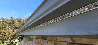

This new rabbit hole is permanent outdoor holiday lights for the house exterior. The wife and I have both commented on them before at various times and thought they looked really nice, and she likes outdoor decorating for various holidays, and well I'm a sucker for LED's so yeah here I am.
Goal for now is to get the main street facing elevation done in time for Halloween, we have a corner lot though so next year may try and add the side and back elevation though with a 2 story with walkout basement that back elevation will require a lift as I'm not doing that from a ladder!
The lights are 12v strips with individually addressable LED's and will be run by a controller that supposed to be here Saturday and can do all the fancy programmable effects.... or so I see on YouTube.
Where there are gutters, the aluminum extrusion is being mounted to the fascia board and the channel will tuck up under the gutter and hopefully just disappear to the average glance:
Extrusion mounted, the strips are stuck to it with double faced acrylic foam tape
With a strip of lights up:
And with the cover lens over the extrusion:
As these are 12 volts, there is less voltage loss than 5v systems so you don't have to inject juice in as often, in this case every 32' which is 2 strings. With some planning I think I know how I'll handle most of the front elevation from a power standpoint with the controller and power supply being in the garage which is roughly the midpoint of the front elevation but sure I've overlooked a number of items....
Without the controller in hand till Saturday I don't think I'm going to put up anymore of the light strips, but am hoping to continue to mount channel and get that into place while I've got a couple days off and nice weather. Hopefully the rain holds off once that controller shows up so I can test things out then really get started!

Very very cool!!! Can't wait to see all the details, just don't tell my wife :D
But it would be awesome on the lake house! That long straight run would be easy and and have so many possibilities for lighting up the weekend parties at the lake!

Built-in, never-take-them-down, holiday lights. Brilliant. No pun intended. No more untangling ridiculous strings of lights that may or may not work when in place. No more tracking down dead bulbs. No more putting the mess away after the season. Just flip them on....then off. They stay put.
What a concept. Well done.

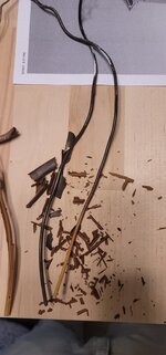

And while attempting to find the top plate to drill thru I found this gem of wiring going to a ceiling fixture in a closet....so I need to dig out a metal box, some cable clamps and a couple foot of romex to take up cut out then splice in a fresh couple of feet to fix this near fire. There was no soot or burned insulation around it so not exactly sure what happened here yet...but needs fixed before I forget about it

Not as bad as I initially thought but still needed replaced. Appears as if the neutral leg got hot, but wasn't hot enough for long enough to damage(other than discolor) the insulation on the wire, just the jacket. Had to go back to the big box though as I didn't have any romex after living in the Chicagoland area where it's not allowed I had finally gotten rid of it!

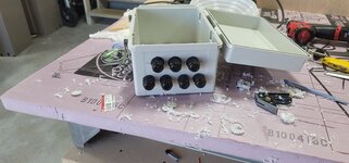

Lots of pictures...not many words for this one as I try and get done before supper!
The brains of the operation:
Now it's looking like something is gonna happen....
Trying to do a nice clean job of flux and solder on these. The strips are cuttable at the copper pads, (4) wires but really only (3) are needed as the center pad marked 'B' is a backup data channel. Note these ARE directional so you have to make sure your data is flowing the correct way as shown on the arrows
And the grand bench test in the garage....didn't take much time to get the controller booted up having already watched videos on how to do that and voila:
