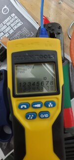

Got that back together and switched gears a bit to getting it on the network so I could easily push programs to it so went and found the network bag of tools as I already had a cable run to this area but hadn't terminated it yet
And success...well for that run...still need to terminate it back to the network rack but that'll be tomorrow

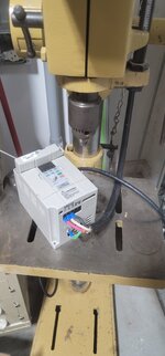

I should stay off certain parts of the internet.....another too cheap to pass followed home...
Powermatic 1150 drill press. A true variable speed with a reeves drive or similar like this has been on my want list for a long time. Changing belts to change speeds *****...well no excuses with one of these as it takes longer to change the bit than the speed.
Its not all roses though
Eagle eyes will see that big ole 3 in the phase box on the name plate so this will be getting one of the small single horse 120v or 240v single phase in, 220/240 3 phase out vfd's. Came out of a local high school that was upgrading, missing some hardware and bolts but should be a very nice upgrade to my old Walker Turner. $200 and a 20 minute drive....so if I hate it should be easy to more than cover my costs after its running on 120v
Question: Since it's getting a vfd, is running a remote speed adjustment knob and reverse switch to the front of the machine worth it? Variable speed is already there...but with the vfd switching direction and slowing down is easy...so why not?

Very cool tool.
It's like a semi with a twin stick ******, way more speed than you will ever need,
You'll probably set the vfd and run it up and down with the vari speed handle on the machine. But that's just me. Make it cool!
Twin sticks are cool! Had a straight truck on the farm that had one, the old Mack dump truck has one as well....scary fast in reverse lol
I do agree, will likely use the mechanical speed adjustment as default and only adjust VFD speed when necessary.
Vfd got bought and the control panel for it can be remote mounted so it will mounted on the front under the existing buttons in a 3d printed housing. I'd like to put an LED spotlight in the bottom of that housing and illuminate the workpiece but have to check angles and if that will work or not
Great deal on the 1150. Those are going for $750-1100 here.

I have the same Powermatic drill press, just the older grey generation. I use a 120v 1HP VFD as well. I only use it as a phase converter. Works well. Highly recommended. That's a lifetime machine!
Lifetime machine is my hope! This paint scheme is my least favorite color but I'm not going to repaint so I'll learn to live with it. VFD supposed to arrive on Tuesday so maybe next weekend have it spinning. Have to decide how I want to do the on/off, I've used some that had a movable box with a big magnet on it so you could position it where it was convenient for the job but just rewiring and using current pushbuttons would be easiest. Short term I can use the buttons on the remote VFD panel so I have options and can use it a bit before I commit

Vfd wired in on drill press to ensure it works....now to determine the easiest way to bypass the current motor starter hardware as I'd like to keep it physically attached to prevent it from being misplaced
