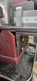

4" x 6" Harbor Freight Bandsaw Chip Tray Bracket - 3D Print

Some more info on the outfeed extension would be appreciated.
Here a few pics of it. To compensate for the angled side of the saw frame casting, I milled the side of the mounting bracket at an angle and fabricated some spaces to fine tune the fit. Alternatively, you could heat the bracket and bend it to the desired angle or weld two pieces flat stock at the desired angle. Hope this helps.
One could also drill and tap a couple of holes in the upper section of the bracket and use two setscrews or bolts in them for fine tuning relative to the casting.
