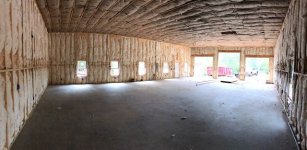

Things are moving right along. Decided to drywall the entire inside in rather than use plywood, which was my initial plan. I think the drywall will visually finish better than the plywood and with so much more space I hopefully won't be banging into the walls as much as at my current house.

While I like the look of metal walls and ceilings in some garages, I think drywall is the right choice for yours as well. I really don't care for plywood or OSB on interior surfaces, and I think painting the latter only makes it look worse. That being said, I really have an intense dislike of sprayed-on popcorn ceilings!

Only advice I'd offer is either moving the compressor as far from the blasting cabinet as possible, or run the supply line all the way to the front of the shop & back again to ensure cool air supply before it enters the water separator by the cabinet.
Good call! The cabinet placement is just tentative but your suggestion makes good sense.
