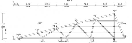

I ordered the equipment shed trusses and beams. The front posts are spaced 14' apart, the rear posts are spaced 10' apart. The front glulam is 15.5" x 5.5" one 40' beam one 30' beam.
The rear glulam is 10.5" x 5.5" one 40' beam one 30' beam.
The end trusses have nailers.
