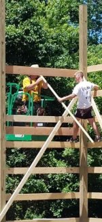

Put the first pole in the ground on June 6th and set the trusses on July 3rdIMG_4752.jpgIMG_4761.jpgIMG_4780.jpgIMG_4819.jpgIMG_4822.jpg
B
Blumafia
Feb 12, 2020
75
Indiana
Weather has been a challenge the whole time, I’m 40 (definitely not 25 anymore) and my son is 15.
It has been cool to spend time w him and teach him how to build and work. IMG_4856.jpg61646160319__07C095D6-B690-4A2E-BCC0-3B1940201F80.jpgIMG_4880.jpgIMG_4882.jpgIMG_4889.jpgIMG_4921.jpg
