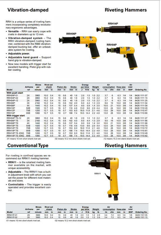

Atlas copco have a joule rating for each rivit gun, I found that helped me to compare what level, x4 x6 x8, each hammer fit into and their competitors.
I did notice that, which does help. But having never used any of those types of guns makes it hard to understand how it will actually work out, what kind of "feel", trigger control, and so forth it will have versus the competitors. But yeah, based on what I've read here, something equivalent to the 16J Atlas Copco RRH12 would probably be about the perfect amount of overkill for me, personally. But will any other brand 7x rivet gun perform similarly to this one? I know guys here are happy with those, but what if they'd bought another brand? Does it matter at all? Or is it like using a completely different tool?

I have bought several Atlas hammers for a shop I work for. All tools are shop owned the air hammers are shared among several mechanics. They repair farm equipment, construction, earth moving and trucks. I can state the Atlas guns perform and last very well in this difficult environment. One RRH12 broke a sleeve in the nose steering the bit. Parts are available via Atlas dealer but very expensive. I can't really blame the hammer for braking considering it's often used as a pry bar so to speak. This happened after two years of heavy use.
One hammer we have is RRH8 with 8 joules per blow. I was removing big nut from large transmission with it and it didn't move after considerable hammering. RRH12 removed the nut in just seconds. So there is considerable difference between 8 joules and 17
The downside I have with Atlas hammers is I haven’t been able to find quick change chucks. And the stock springs are fragile and , at least over here, rather expensive @ $60 each!
I have had shards of steel flying with RRH12, one went through a glove and dug into the palm of my hand. Perhaps there is a limit to how powerful air hammers companies like to market for repair work. It wouldn't surprise me if the bigger rivet guns are considered unsafe for hammering on steel. Riveting is a different process than banging on all kinds of steel. Using these guns on full power is dangerous. Not Garage Journal safety nannies dangerous, where everyone should put on face shield before using a screwdriver. This is real..
If you get RRH12 or 14 be prepared to buy some extra bits. They break frequently. Unfortunately I don't have any experience with other air hammers.

There is no doubt the Japanese CP717 is great tool and highly recommended. It's derivatives are probably great as well and well suited for general automotive work up to 1 ton pickup trucks. However judging by energy per blow numbers and air consumption these hammers have less than half of the energy of a 7x rivet gun like the Atlas RRH12 and would probably leave much to be desired for great many things.
The Atlas sports floating barrel and behind the barrel is compressed air pocket dampening the vibration. So while you watch the business end doing the work of several BFH (big fuc*** hammers) you hardly feel a thing. This give you control of the hammer, without the vibration dampening it would probably be very difficult to hold and control. Even impossible.
Our guys who work on the biggest trucks and trailers you find on the road and off, absolutely love the big Atlas guns. With their vibration dampening and great trigger control they have saved many days.
Your selection of air hammer depends on your needs and what you are working on. The "Big Nasty" for example seems to be great tool for decent price and will probably do everything needed in general automotive up to one ton pickup trucks. For larger equipment probably not.

Well put, Olafur. Being that you have been up close and "in it", so to speak, with these tools, I will take it that this is probably a very accurate breakdown of the applications for these tools. Putting them in "brackets" and defining a rough cutoff for philosophy of use is helpful.
That said, it sounds to me like the RRH12 is useful over a far greater range, what with its adjustability. And the caveat would be its much larger size, limiting its ability to help on many applications - especially on smaller vehicles (1 ton and under with smaller clearances). Would you say this is accurate? Or am I off base with the first remark in this paragraph?
For anyone curious, here is an old video demonstrating how the vibration damping works and the difference it makes in short and sustained use:

There is no doubt the Japanese CP717 is great tool and highly recommended. It's derivatives are probably great as well and well suited for general automotive work up to 1 ton pickup trucks. However judging by energy per blow numbers and air consumption these hammers have less than half of the energy of a 7x rivet gun like the Atlas RRH12 and would probably leave much to be desired for great many things...
So the CP717 is too small? LOL. Sounds to me like we have a consensus. The CP717 is a benchmark.
...For anyone curious, here is an old video demonstrating how the vibration damping works and the difference it makes in short and sustained use:
